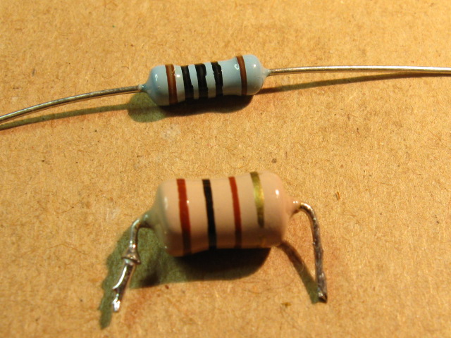

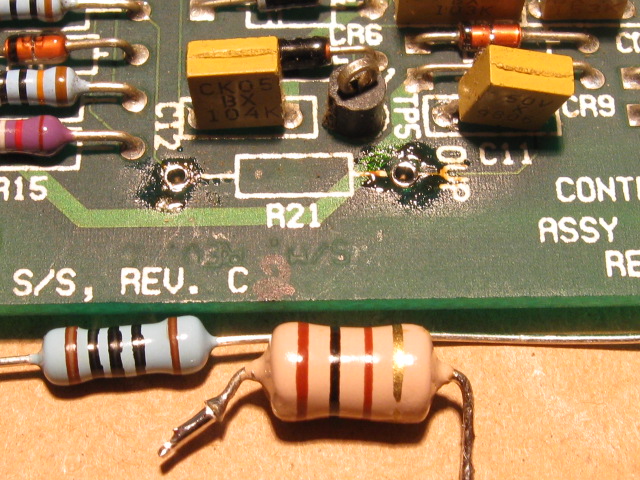

I'm still going through my problem child spare HVPS and came across a large 100R resistor @ R21 on the Control PWB that had obviously been replaced (see pic). I measured it in and out of circuit and it appears to be close to infinite. ~.006R Fluke 23 Series II.
Looking at the pic, is this large (1w or 2w?) resistor a fusistor? The other 1/2w resistor is there for size comparison. That fat boy resistor is the only one on the board of that size and rating so not sure if it's supposed to be there or if that's all somebody had when they replaced it. The rest of the boards foil side is clean except for the area of this resistor which shows heavy flux buildup so I know it was replaced sometime in the not too distant past.

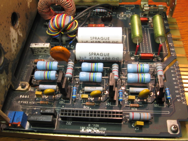

I tossed in a pic of the HVPS after new parts install.
Wide view of new components
 Filesize:  150.98 KB
 Viewed:  15820 Time(s)

Thats what is called a color wheel inductor, its not a resistor. Who ever replaced it before you owned it screwed up.
Posted: Tue Jun 29, 2010 7:13 pm    Post subject:
That's a new one on me! WTF is a color-wheel inductor? How can you tell it's one of those and not a resistor? Other than being a little chubby it sure *looks* like a resistor...
Posted: Tue Jun 29, 2010 7:20 pm    Post subject:
No kidding, Gary! I had no idea, either!
So, how the hell do you tell the difference between a 100-ohm 5% resistor and a 100-microhenry 5% colorwheel inductor?
Damn, I learn something new every day!!!
Posted: Tue Jun 29, 2010 7:26 pm    Post subject:
Yepp, thats what they are called.
http://cgi.ebay.com/10-pcs-Color-Wheel-Inductors-1000uH-1nH-10-/290446823911?cmd=ViewItem&pt=LH_DefaultDomain_210&hash=item439ffad1e7#ht_1340wt_754
Some look like Carbon Comp resistors. look on the Marquee VNB, they used all different types on each of the 85 volt rails.
Its not easy to tell them apart. You have to look on the PCB silk screen to know for sure. When not in a board and left lying around you could screw yourself.
I have them marked in littlebags and take one out and put the rest back right away as to not get them mixed up.
its also good to have an LCR meter so you can make sure you know what you have.
Posted: Tue Jun 29, 2010 7:36 pm    Post subject:
Yeah, obviously if the board is marked properly, you should know... I meant what if they're laying loose... So, if they were just laying around loose, there's really no way to tell the inductor from the resistor visually... You literally need a LCR meter to tell them apart.
Good to know!

I have one HVPS controll board here. R21 is normal 100 resistor 5% tolerance. "normal" size also so 0.5W should be OK.

Ahmmm....if thats a X2394 then R21 is not 100 ohm (unless there was a change from the print). The color bans on that resistor/inductor look more correct. Greg, what exactly is that component testing to be ohm wise?
Let me correct my phrase of the color bands on that device. Are they red/black/red or brn/blk/brn or red/blk/orng

The colors are brn/blk/brn/gold.

Yup you are correct. As suspected (expected?) replacing it with 100R 0.05w 1% didn't bring any love. Still cycles up once, twice, then off until the power button is pressed again. rinse and repeat. Same LVPS and C light (C lights up without pressing any remote buttons) as before.

Mac, the colors are brn/blk/brn/gold.
I installed the 5 band 100R/0.5w/1% but no go. I 'think' I pushed an already weak IC over the edge when I reflowed it. I need to find a procedure to test them with a DMM, which is all I own.
