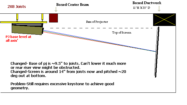

See attached crude graphics. I exaggerated the suspected trapezoid issue.
The only thing I've done after a full reset, with CPC"s nulled, is mechanical focus, electrical focus, PIN top/bottom and sides, H&V Size and Keystone. I'm almost finished with Scheimflug (blue is fighting me a bit).
I haven't set up this pj from scratch more than 3 times in 5 years so can't remember if the rough graphic I've attached is how it looked after reinitializing. I'm running a different set of heatsink boards and haven't put the originals back in to test yet. I'm on my way to bed so no time to check before posting this.
I'm also having to run Keystone down to 5 even though I've just lowered the pj down ~4" all the way around, raised the screen as much as I can, and angled the screen out at the bottom around 15-20-ish degrees. The pj is level at all axis' but I added another 4-5 deg to the built in 12deg by adding a nut at the front between the AllThread and the Unistrut. I can lower it down only a bit more before obstructing the view from the rear riser seats.
Also, as you can see in the exaggerated trapezoid graphic the linearity is also funky. I have to run Vert S linearity all the way up to almost 100. (I think it's vertical S...too tired to remember.)
Given these three things I think are out of the norm I'm inclined to think something is up with a board but I'm not sure which board specifically might be responsible. I know the VDM and HDM are involved in KEY PIN from recent problems I was having but after that I got nothing. I'm fairly certain I have the pj square to the screen...I put three hours into trying different methods. I suppose it could still be out but I doubt it.
Any ideas?
Thanks again folks!

Posted: Thu Jun 24, 2010 9:48 am    Post subject:
Which way is it keystoned at null on the key settings? Looking at the picture at the top there it looks like youve got the screen about as parallel to the lens faces as you can, would this be the case? If that is the case, i wouldnt think youd need any keystone correction at all.
Is the screen the exact same distance to the projector on both sides? Does the right corner of the projector to the right edge of the screen and left corner of the projector measure the exact same amount? Are the rasters all doing this as well or just the projected picture? If its just the onscreen image it must be a location issue, but if its how its leaving the tube faces, well that is something else.
I wouldnt expect you to get a picture like the one you describe with the bottom image unless the projector is cockeyed to the screen.

Posted: Thu Jun 24, 2010 12:47 pm    Post subject:
Greg,
If you are that confident in your mechanical setup, then I would turn to your vertical deflection module. That module I believe is what controls keystone and pincushion. If you aren't using your main set of heat sink boards, the first thing I would do then is swap them out with your originals now that you found your other issue and see if that resolves it. I have some thoughts on what's wrong, but I'll PM you since that's diving into the details. Laughing

Posted: Thu Jun 24, 2010 9:17 pm    Post subject:
That was my plan last night (early this AM!). It should be close...within +/- 5 degrees.
I'm going with yes but you know how it's easy to second guess yourself so I'll triple check it again.
Again I'm going with yes but will recheck
See next answer
Good point but IIRC (sinus meds don't promote that at all) all patterns were square on the tube face before putting the lenses back on. I'll pull them again to make sure. If the patterns are square on the faces logic dictates it MUST be the pj orientation. I'll be damned if I can see how I got it that horribly wrong tho. That damn boxed in beam prevents me from measuring from the foot bolt holes to the screen so I'm trying to figure out how to get good measurements. I'll have to try using the tube top plate bracket.
Agreed.

*sigh* To hash this out anyway...
1) The screen is angled ~4 degrees out at the bottom
2) The pj is at 10 degress from center of green to center of screen (angle gauge on green mount plate)
3) The top edge of the screen is 12.5" from the ceiling, the pj base is 8" from the ceiling
4) I just confirmed the screen and pj are centered within +/- 1/4"
If I angled the screen another 6 degrees would that negate the need for excessive KEYSTONE and additionally get the light back down to the viewing height?
Man...I REALLY had this setup poorly for the last 4 years! I don't remember using this much KEYSTONE though.

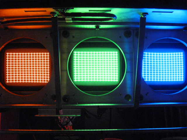

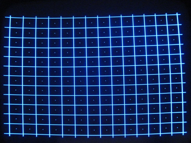

Different issue...As you can see in the pix the blue tube geometry is bowed up (down when inverted) whereas the G&R are close. If I add any more pin to the tops of those two it's over exaggerated at the blue and I end up with a worse hump.
Something is wrong with the blue tube PIN even with a full initialization. I've changed the VDM and gone back to the original one but it followed.
Blue grid hump. Can't adjust it out without over adjusting G&R
 Filesize:  147.42 KB
 Viewed:  9766 Time(s)
After a full initialization and nothing but PIN and Focus adjusted. Notice the blue pattern sag/hump
 Filesize:  132.38 KB

Posted: Fri Jun 25, 2010 1:57 am    Post subject:
Greg,
That blue pattern looks similar to what I had in my pj if I recall, so that maybe the magnetics setup on the blue tube.

Posted: Fri Jun 25, 2010 3:44 am    Post subject:
Greg , Paul is right, you do not have your convergence yoke aligned right from what i can tell. With the PJ on and being very careful not to get zapped loosen the clamps and use the wires to move the Convergence yoke, slight changes make big moves so watch the tube face while doing it. when you get it right you'll know. the dips and bumps will be gone.

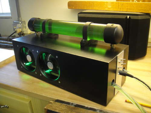

To hijack my own thread...because my brain somehow wandered to the heat that will be generated driving the electronics so hard...
I've been putzing around for several months as time permits pulling the parts together to convert the rear heatsink from passive cooling to active via liquid cooling. It's based on a project for PC cooling but mine is more...robust. Mr. Green (Pic attached)
If I can ever get this pj setup hammered out that's next on the list. I've attached a pic of the design I based mine on except mine will be a wall mounted food grade stainless NEMA enclosure inside an insulated sump pump closet in the corner of the theater. Should be a fun project.
Nifty looking but mine will be more utilitarian.

Posted: Sun Jun 27, 2010 4:14 pm    Post subject:
For the blue raster shape try unplugging the blue convergence coil and see if it straightens out. If it doesn't check that the blue deflection yoke is hard up against the tube bell. If it is tilted in reference to the tube screen you can get the shape that you are showing. You might have to remove the hot glue to get it placed right. If you have to do that be careful to not pull the wires out of place on the yoke.

Posted: Sun Jun 27, 2010 8:09 pm    Post subject:
Tse is the resident expert here but I'm going to back him up. A tilted deflection or focus yoke WILL cause a sagging grid pattern as seen.
I think that it can also be caused by the yoke in question having a balance issue. If there's a turn to turn short in a deflection yoke, it will reduce the amount of current drive through that coil, and deflection yokes work on well balanced pairs of coils.
It's not impossible that it could be an unbalanced yoke drive signal, too, which would point at an issue on that channel of the HDM.
In the case where it could be due to a focus coil, which is mechanically set up correctly, then it's possible that the static magnetic field
strength from the internal permanent magnets could be non-uniform. In the case of the Thomson focus coils, this is very possible as
the magnet structure consists of six cylindrical magnets between two steel plates, in a squirrel cage arrangement. If some of those
magnets were to be well off their proper strength, it would cause the total magnetic field shape to be off, and geometrically similar to
the field generated by a tilted yoke.
Check the yokes. Focus first because they're easier to get to. Check alignment with the coils disconnected. If the sag is still there,
swap the deflection yoke drive cables between this tube and one other. (It's generally best to leave green untouched since it's your
point of reference.) If the sag switches to the other tube, it says bad HDM. If the sag doesn't change, it could still be either the
focus coil or the deflection yoke. swap the focus coils between this tube and another tube. Then try swapping focus coils. If the sag
still doesn't move, then the last thing left is the deflection yoke. In this case it might be better to just pick up a spare deflection
yoke from Curt (I'm sure he's got a ton of them) rather than have to go to the effort of stripping down TWO tube stacks and realigning
