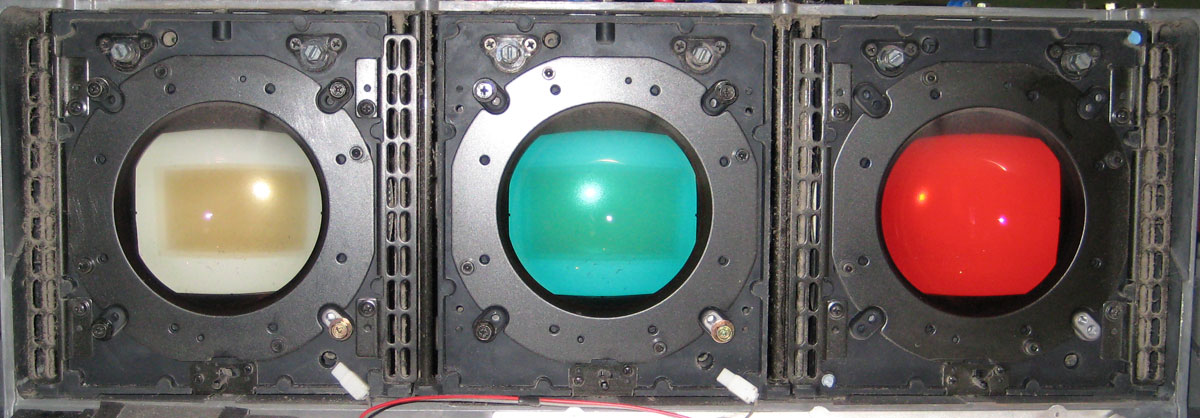

I've just bought my first G70 - 3600hrs on the tubes. (yes we still get excited about G70's here in Aus Smile) I've had a Sony 1272 for a few months now which after figuring out how it all worked I love - seems like a great unit to me so I figured the G70 must be even better....but.....
The problem.
I think it's been run too far back (see tube face pics) and been moved at least once. At the 'correct' distance from my screen (100inch 16:9) I can see the wear, at least in the test patterns so far, and my room won't support me moving the PJ any further back. Ah the disappointment!
In the opinion of the pros here are these tubes really no good or am I being too fussy? The guy I bought it from said the blue tube was a 7.0...but now I have the lenses off it doesn't look like a 7.0 to me (note to self always see the tube face pics!)
Options
I've done a bit of reading, and it seems like my options are:
1. I can swap out the green and blue tubes from VDC for around $1500 plus shipping from Australia each way (gulp). Is it worth getting them to do the assembly or is the bare tubes installation doable for a careful novice?
2. Find some good secondhand tubes on ebay or in the buy and sell forum here
3. Boost the output of the green and blue tubes (will that solve it?)
4. Any other ideas???

Sorry to tell you but those tubes are about a 4 according to Curt's tube wear chart... i.e not good for movie watching.
You will have to source a new or good condition green and blue.
I would hunt around for someone who's parting out a set and do a deal on the tubes,will be much cheaper than getting new from VDC.Maybe Curt has something?
So the seller told you they were a 7? I would ask him for some sort of compensation,as the set is definately not as described.

That blue is a 5 at best. The seller either misrepresented the condition of the tubes or was ignorant himself of the exact condition. Either way, it's a bummer.
Don't spend big bucks on tubes from VDC - these machines just aren't worth enough money to justify that. Just be patient and watch the forum and eBay and buy some tubes with hardware installed. Shouldn't take long - with prices the way they are, I think we'll start seeing more parting out.

Thanks for the replies guys - looks like the tubes are toast then. I was pretty gutted when i switched it on and saw the warm up white screen with brown in the middle, I thought all couldn't be well with my new toy.
The VDC option seems ultra pricey - around $AUD 2000 plus shipping, kind of a last resort for me. Still despite this, I'm a CRT convert, they're big, heavy, noisy, and a pain to set up but they just throw a really good picture, and have a certain magic to them (although the only picture I've ever really seen is a Sony 1272 so far)
If anyone has any good condition tubes for sale, or knows of anyone who has some let me know. Consider this opportunity knocking for anyone parting out a G70 Smile

Looking at those tubes, they are pretty shagged, if you could keep it in the wear pattern it would still look pretty good, but probably wont last long before itll be too hard to get good colour balance.

If you could move the projector back more and stay within the darkest wear pattern the image would probably look pretty decent. But since you can't pull the projector back anymore that option is out.
The other option (which you won't like Wink) is to run a smaller screen to keep the image inside the dark section of phosphor.
What I would do until you score new tubes is just set it up and run with it. Calibrate the gray scale at the center of the screen. You will notice a different gray scale outside the wear pattern, but if you don't dwell on it you'll still be able to enjoy the projector.
Whether the tubes are 7 or 4 you would still have this issue in your size room because you wouldn't have been able to stay within the existing wear pattern. For your situation you should look for new tubes, or tubes with zero visible wear.

...you need all three tubes, not just green and blue. You may not be able to see the wear pattern through the red, but it is there and on the phosphor. If you don't also change the red tube you will still have a discoloration around the boarder of your projected image.
So do get a full set of all three tubes.

The G70 is still a pretty beasty projector, but yes, they dont come up often at all, and when they do youre right, if you have the money grab them and either do something with them, gut them for parts, or sell them on if you decide you dont want it as much as you thought you did!!
CIR is right, you need 3 tubes, i was going to replace only 2 tubes in my Sony a couple years ago, but Curt told me that is a bad idea so i took the red as well, and when i compare the 2, the new red is not only 100% wear free, but its WAY sharper ( due to it being an ES focus, the G70 probably wont make much difference cause its EM focus. )
Here is what my Sony tubes looked like and within that area it still threw a pretty decent looking pic for a 576i machine:
