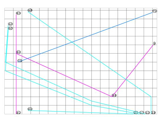

i decided that if i'm drywalling in the ceiling, then i need to pull an extra circuit to an accessible place and so i pulled a 8/3 220v 40a circuit to the closet of the room next door. then i spent a day figuring out how to pull the audio cable through the wall and avoid the AC lines. here is the sketch of the layout.
purple is hydro (H1,H2, H3 and H4)
dark blue is video (V1 to V1)
light blue is audio(A1, A2, A3, A4)
So you're obviously putting your MIG welder in your theatre. Aren't you concerned about extraneous light messing up the picture?
I faced something similar, Lance. My solution was to keep as much vertical separation as possible between the AC lines and the signal lines, and wherever they crossed, I kept the angle as close to 90 degrees as possible, which according to your sketch, you have done. So far, no problems...no hum (which the electronheads here will call a "ground loop" or some other non-descriptive term), which is what I was most afraid of.
I've also had success limiting AC-induced noise in the past using BX (armoured cable) for AC wiring (because the armour acts as a shield), and using RG-6 for signal distribution. Not inexpensive, but effective.
