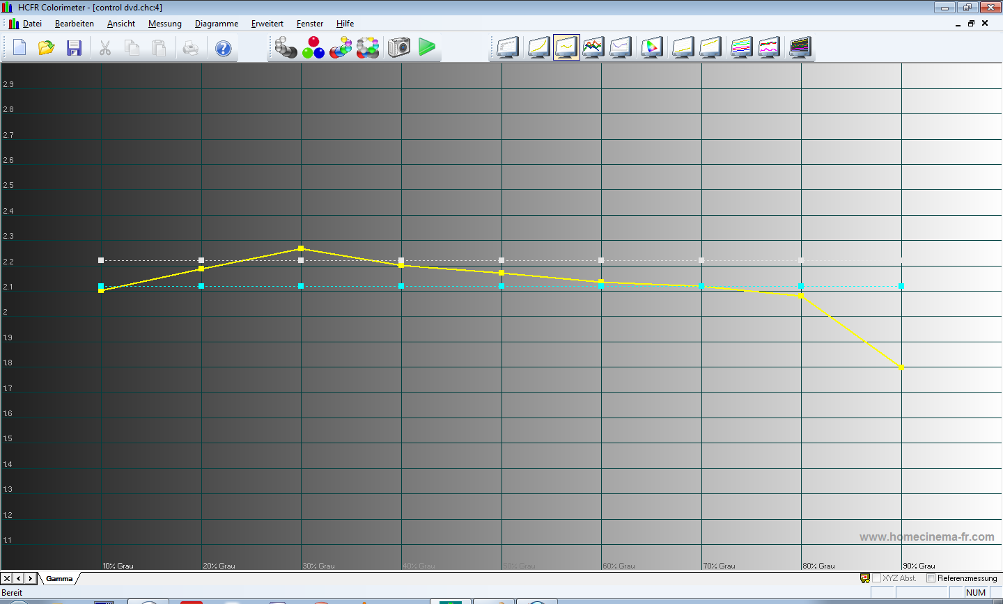

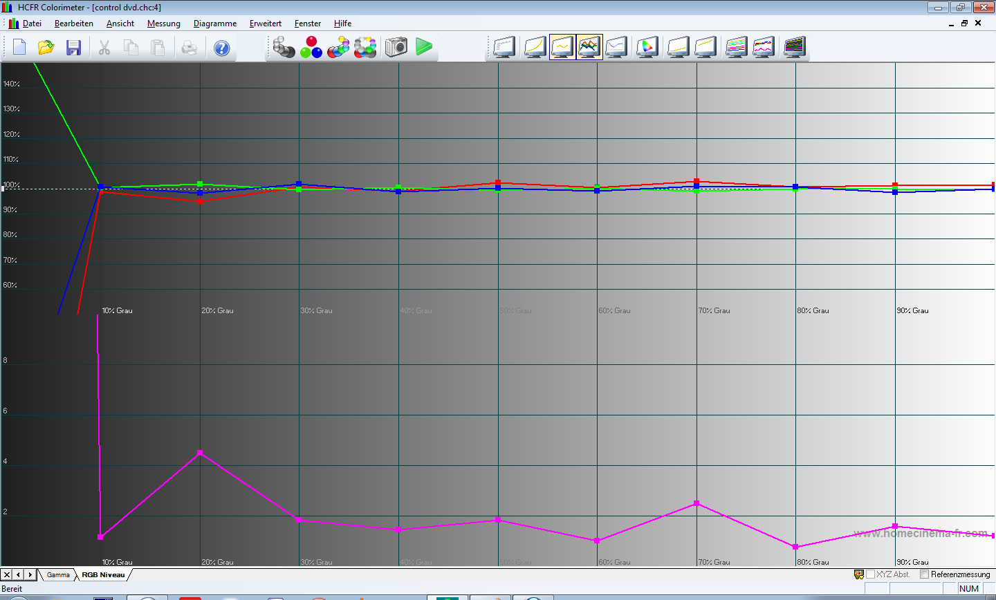

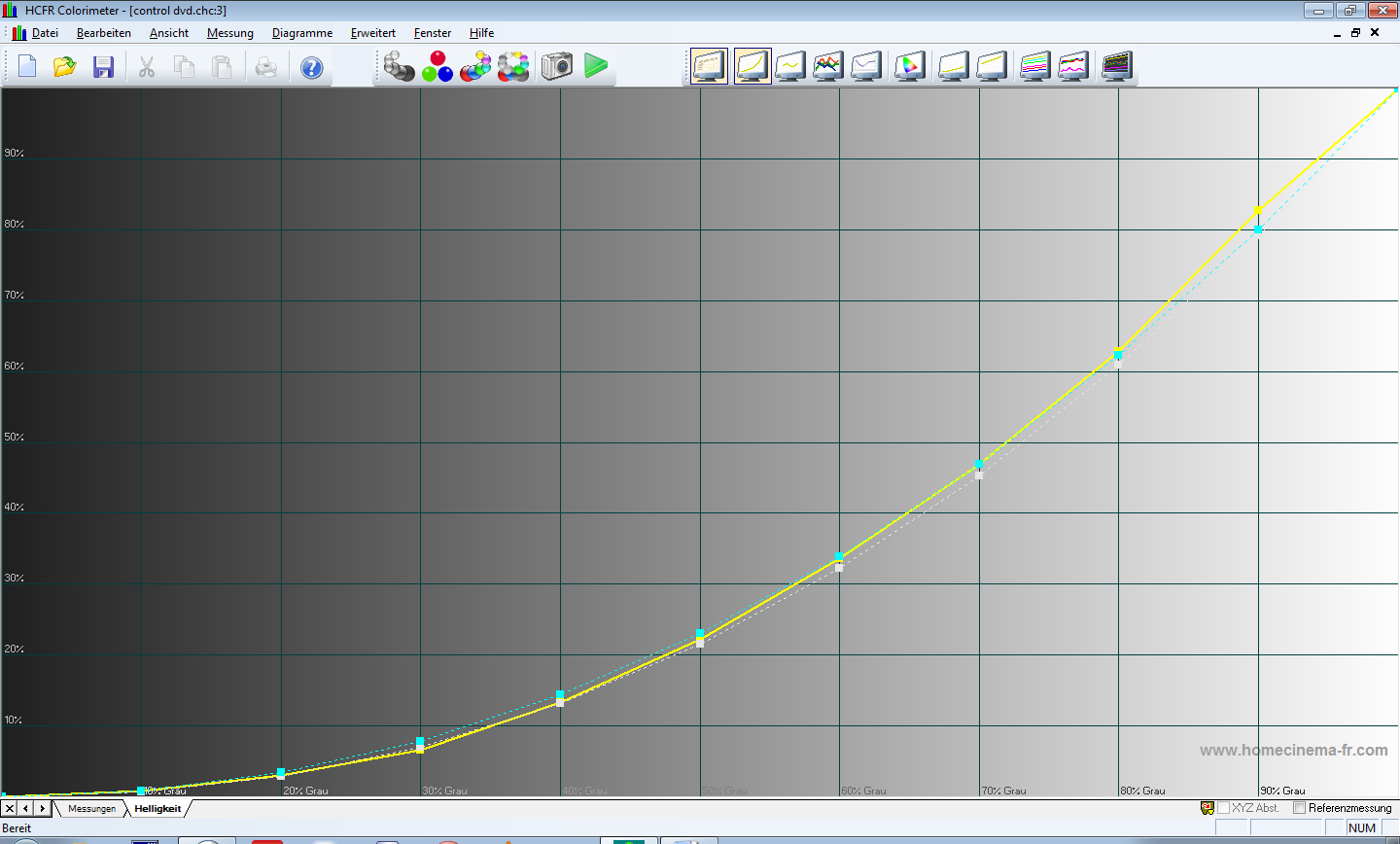

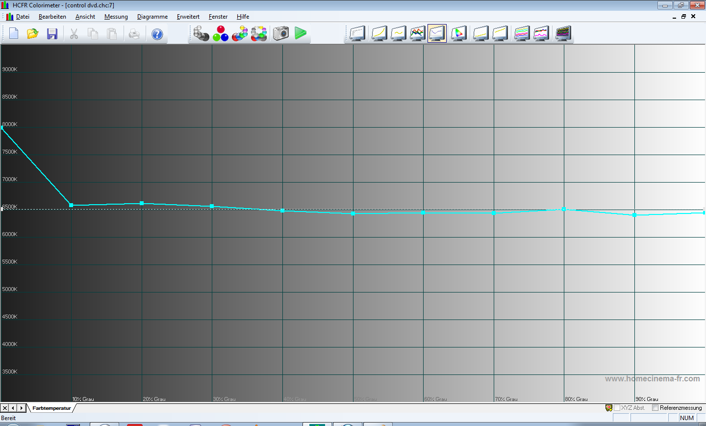

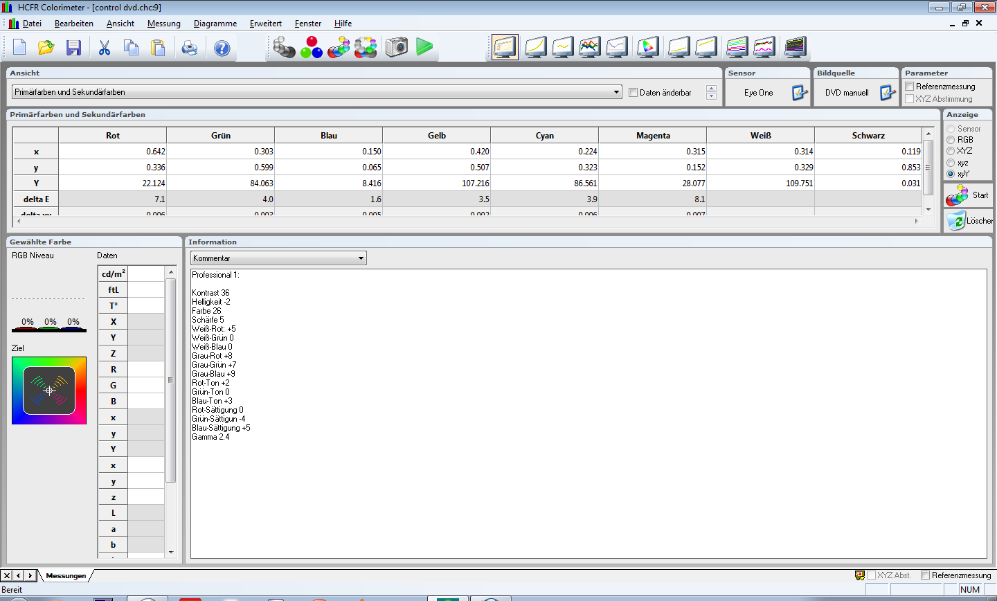

I just tried to calibrate my Plasma-TV (Panasonic G20) and got the following results:
See files below.
Even though I believe I got quite close to D65 (except for the gamma and the coloursīluminances) I have a problem.
When I switch through the test patterns from 0 to 100 IRE everythingīs fine, but when looking at a greyscale ladder (with little squares of grey lined in a row from dark to bright and vice versa) some grey shades tend to have a reddish tint.
How can I have tinted greys with a calibrated grey scale?
I used HFCR and an Eye1Display 2.
I followed the guideīs steps and used the AVCHD 709 (with the colour gamut in HFCR set to REC 709).
What did I do wrong?
Besides: would the wrong luminances and the gamma effect the picture very negatively?
Iīd be greatful for any help.
Thanks in advance and sorry for my English, but Iīm not a native speaker.

I'm not an expert but it all looks good to me. The luminance isn't so far off that it would cause an issue in my opinion. I'm not sure what you mean by the reddish tint though.

I didnīt mean the overall luminance but the primary and secondary coloursīluminance.
Theyīre supposed to match the following:
(compare the 100 IRE Y values of white to those of the colours)
Red 21 %
green 72 %
blue 7 %
yellow 93 %
cyan 79 %
magenta 28 %
In my case thatīs:
Red: 20%
Green: 77%
Blue: 8%
Yellow: 97%
Cyan: 79%
Magenta: 25%

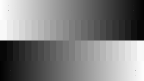

I attached another picture of a greyscale ladder below.
What I mean by the reddish tint is that some shades of grey in the picture seem to have a touch of red in them.
Not in this one though, since I just downloaded it somewhere to provide a sample of what Iīm talking about.
Iīm a little confused.
Thanks again.

I did the 2 point calibration at 80% and 30% white.
Iīm not sure, if I can tell which shades of grey correspond to 80 and 30 in the testpattern, so I canīt really say if the calibrated shades are free of any tint or not.
But the funny thing is, that when I switch through the patterns from 0 to 100 % (the ones that have a single square in the middle) the colour seems ok, I donīt see those shades.
Only on those ladder-patterns.

One more thing here, because your RGB levels are very good through all IRE's but to you it looks reddish then I'd says its the probe. A good probe would have shown either a low green or a pushed red etc to correspond to what your eyes are seeing.
