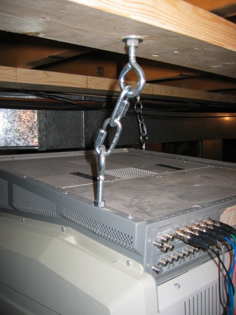

Posted: Sun Jun 06, 2010 11:45 pm    Post subject:
This. And I really, really suggest against it.

Posted: Mon Jun 07, 2010 12:27 am    Post subject:
Heh. I admit that the thought of using chains like that had crossed my mind. Doesn't seem very stable though.
I think that the simplest solution would be to mount the projector on four threaded rods rammed straight into the
cieling.
No possibillity to adjust anything like that.
Preferably i would like at least some room for adjustment and also be able to mount a winch.
