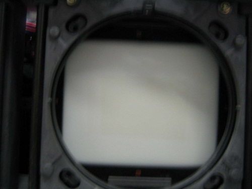

Here is the green tube:
XG75 green tube face

Posted: Sat May 29, 2010 1:40 am    Post subject:
That's pretty watchable. Whoever's watching that PJ will probably stop noticing it pretty quickly.

Posted: Sat May 29, 2010 2:38 am    Post subject:
That's not bad at all my green is far darker and I barely notice it at all, except in full white sceens like Star Gate Continuum's ice scenes.[img][/img]
