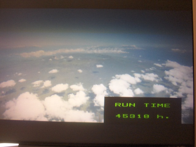

I will add that this set has 45,000 hours on it or so (I'll post a pix in a bit), so I always assumed that the set had been retubed a few times. White balance (save for the blue haze) was still good, but now the haze was unacceptable.
I've seen LC tubes develop fungus and turn yellow, but I don't think I've had a tube's glycol go milky. It was TERRIBLE! There was a thin film of haze on the tube face itself as well as on the back of the LC housing, but a careful cleaning got rid of that, and I'm now reassembling the set. As I was pulling the tube out, I noticed the date code on the tube, 1997, which is the same as when the set was made. So I'm pretty sure that these tubes are original.
The tube face was maybe an 8 to 8.5 on the blue, the slightest yellowing of the phosphor, and while I'm not pulling the green tube, I'd expect it to be the same, maybe 1 step lower.
So to me that's pretty amazing, an RP set, 72" with 45,000 hours on the original tubes.

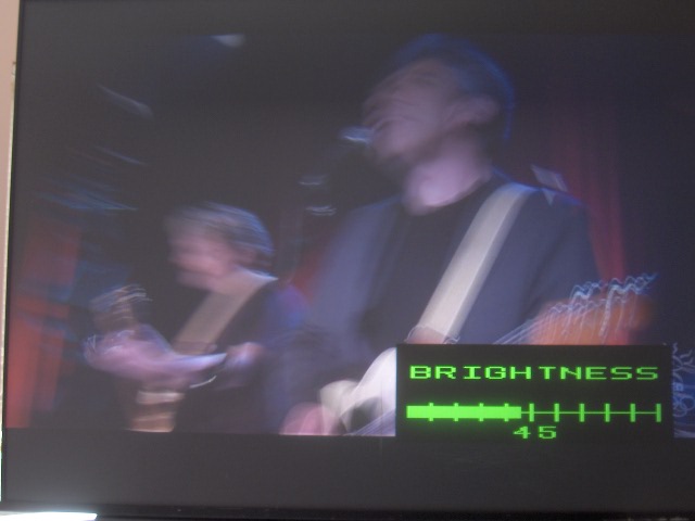

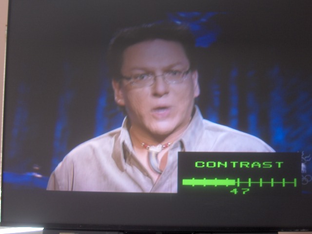

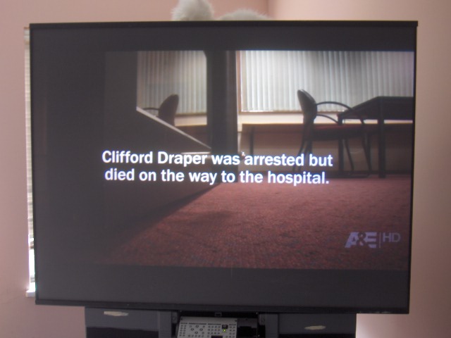

Posted: Sun May 23, 2010 6:05 pm    Post subject:
Set pictures..
 Filesize:  53.87 KB
 Viewed:  3553 Time(s)
 Filesize:  56.32 KB
 Filesize:  70.82 KB
 Filesize:  61.64 KB
