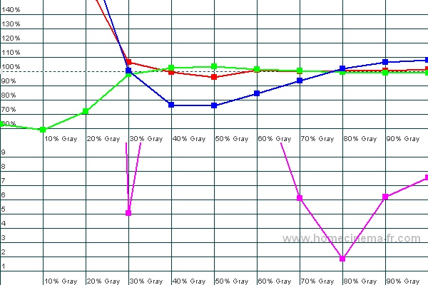

Ok I have been struggling with doing a proper grey scale calibration on my Two marquee 8500 Ultra LongBow's for my Blend. I have alway thought it was my probe. An i1 pro. But these never go bad or show any issues from what i have read and the great guys at Spectracal have told me. LA I owe you big time for putting up with me! Wink
Most CRT's give a blue Hump in between the two points you use for calibration and then it falls of below those two points causing the lower than 30 IRE and higher than 80 IRE to not look right and have a brownish low end and yellowish high end.
Defocusing the blue is what helps fix this problem. You give more light output in the upper IREs where typical blue runs out of steam. This in turn straightens out the hump as you can now lower the G2 and Drive as the defocusing helps get more light to the screen.
So here is my problem. I can't defocus because i already get too much blue int he high ends and low ends. I have a blue DIP!!! i always thought it was the probe not reading right. but when i calibrate by eye to get the mid ires and greyscale "looking ok" i always saw too much blue in the upper end and lower end , while 40-60 looked perfect to me.
So i sent my i1 to LA Habelein at spectracal and he and the crew did a work over on the probe and it was fine.
So tonight i ran a D2 i am Borrowing from BoilerMaker and did a few tests and found i get the same blue dip, focused is not as bad as if I defocus. So Do these Longbows have different tubes? i have no idea but what can I do to add more blue to the mid or reduce the blue to the highs? Using the controls in the PJ will not help. I already have drive for blue down to about 7 green drive is 0 . I always found controls for the blue on these longbows have more affect with each other than my other marquee's. A few clicks of say the drive up also raises the low end of the IRE quite a bit for blue.
One thing that helped me fine tune the adjustments is using the marquee PC based control program. it gives much more fine adjustment range than with the remote. i never realize how course the adjustment via the remote are compared to the program. I will never use the remote for greyscale again!!! Now i need to try it for geometry adjustments as well Wink
Well here is my quick run of greyscale . HFCR graph.

Posted: Sat May 15, 2010 2:08 pm    Post subject:
very wierd, I can only image it's related to the peaking circuit on the VIM, nothing else could possibly do this AFAIK.
Posted: Sat May 15, 2010 2:23 pm    Post subject:
That IS weird. I assumed your probe's low end was bad, making the hump "shift" over to 80% or so. But if they've checked the probe, and another probe shows the same thing...
I can't believe it's something about the tubes. As I understand it, the blue hump is a fundamental property of the phosphors used in blue tubes. They just don't put out much light so you have to compensate with defocusing.
I'll be interested to hear what you find about using the PC to do geometry. I've always thought the Marquee's geometry controls were a bit coarse.
Posted: Sat May 15, 2010 4:00 pm    Post subject:
Strange Nashou. Complete opposite of what normally happens as you mentioned!

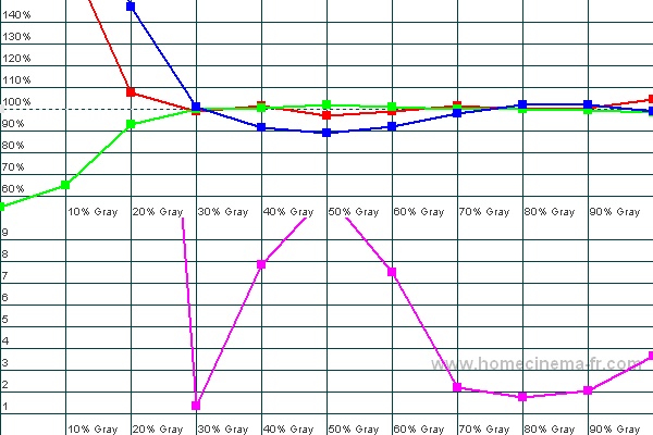

Ok here is the graph of the right PJ with Contrast and Brightness at 50 For the calibration.
No Brightness or Contrast adjustment made afterward.
The Greyscale Steps are also greener in the mid IRE's.

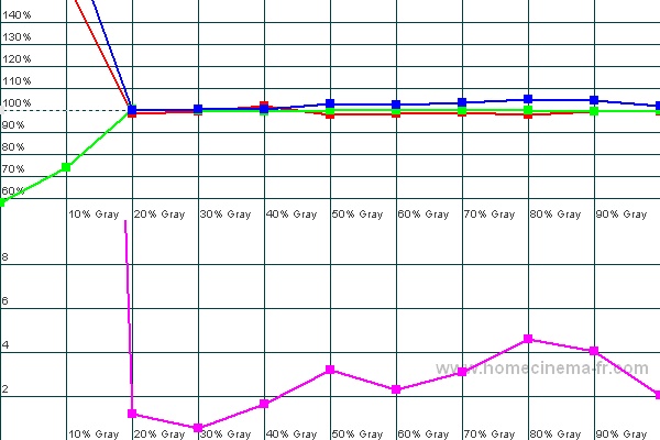

Posted: Sun May 16, 2010 6:00 am    Post subject:
Ok I talked with Bob Stephan and he told me to stop messing around with just the PJ controls and use the Damn Lumagen CMS!!!!!
Ok Ok Ok, I just never seen a blue dip and am curious I told him. So i did my best with 30 and 80 ire in the Marquee and went onto the lumagen Greyscale and then CMS adjustments. So i went through each grey scale IRE and adjusted either blue or red. Then I ran a grey scale. holy sh*t!! What a difference!!! But I did notice my Black level was wayyyyyyyy low now. i had to bring brightness from 50 to 80 I then went through another greyscale adjustment for each IRE in the lumagen. Once i got that i looked at the gamut, they were all off now but secondaries looked really good. So i began adjusting red and green to get them back to reference. blue could not be adjusted to move it closer. So i left it alone. After i got really good green and red, blue is what it is and now the primaried were way off. No CMS in the HDQ for those so i lived with it. i ran another grey scale had to make more 11 point adjustments and then i looked at luminance or gamma.
made some adjustments to try to flatten it out and now it looked the best it ever did. In one of the DVE clips where the red and purple flowers come out of the foliage i always thought the red flowers were all red. they are not there is one that is orange and a couple that have red and orange in the petals. Now I see how over saturated the red was.

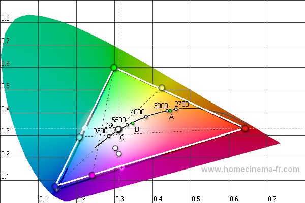

well here are the new graphs:
 Filesize:  76.63 KB
 Viewed:  161 Time(s)
 Filesize:  72.79 KB
 Viewed:  161 Time(s)

Posted: Sun May 16, 2010 2:59 pm    Post subject:
Athanasios - You have the same situation as I do. Don't ask how it happened, but only one of my two VideoEq's is the pro version with CMS. Luckily, crt's have pretty decent gamut's to start with.
What you need to do is use the projector without CMS as the baseline target for the projector with the CMS. Don't use the ideal points as it is more important to get the projectors to match than it is to have one of them perfect. Just save the gamut points on your baseline projector and those six points become your new targets for the one with the CMS.
When you are satisfied with the first one (the one without the CMS), save the peak white level at 100IRE and use it to set your contrast level for the second one. It will look awesome when you are done!
It looks as though you got your sensor to stabilize at 20IRE. What did you do differently?
Bob

So now using the Radiance to get the greyscale, gamma, CMS, and 125 point CMS is much more even since it has less adjustments and more head room to work.
I did one PJ last night and the second i going through its automated paces right now while I am at work. it takes about 1.5 hours for a full auto calibration for the marquee's.
But the first PJ looked really good looking at the Lumagens Greyscale pattern. Only thing I had to do was lower the luma for 0% white to get it to black. using the marquee Brightness lowered everything overall and crushed 5 and 10 %. So I think When I gat home tonight if the Auto Calibrate didn't have a hick up i should have two fairly close calibrated PJ's.

I think i have been almost down there.. I just found the data on my HCFR file from the best grayscale calibration i did before i got my lumagen.
You can see my blue have a small dip from 20-40% and a bump from 60-80%
But i think it should be possible to target 10% when you calibrate, and get that spot on.. It maybe takes a few days.. but in my opinion its worth it..
