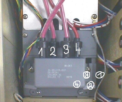

Could anyone tell me which number is for which tube

Posted: Fri May 07, 2010 3:14 pm    Post subject:
just make sure the hv lead from the hvps goes to in on the hv splitter.
the order in which you put the hv leads from the tubes into the splitter doesnt matter.
Maurice089
Posted: Fri May 07, 2010 3:29 pm    Post subject:
which number is the hv lead of the hvps?^^ sry i'm a new crt owner^^
Posted: Fri May 07, 2010 3:50 pm    Post subject:
4 is the lead from the HVPS.

Posted: Fri May 07, 2010 4:05 pm    Post subject:
it is printed on the hv splitter (on the side), at least on mine and i have the same splitter.
Maurice089
Posted: Fri May 07, 2010 5:55 pm    Post subject:
thank you =)

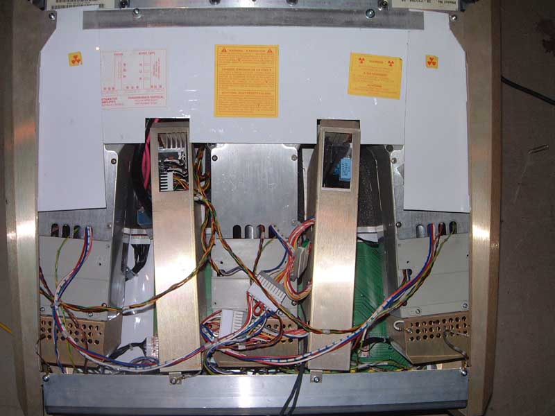

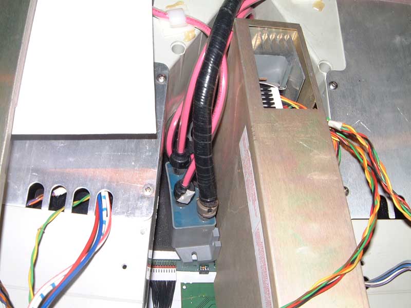

Chris Stevens used to move the hv splitter between tubes and leave it there permanently. He was a big-time Marquee guy who helped design some of the uber-marquee's that sold back in the day. Here's one of his installs:
