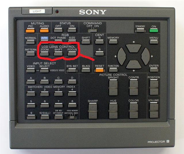

Ive got a lovely Ol Sony LCD Projector which has been strategically moved behind a wall for best viewing.
But I dont have the original RM-PJ1001 Remote to be able adjust the projector via my remote extender
What I do have is a Logitech Harmony One and also a Nokia N95 Psiloc IR Remote Application which can be fed Pronto Discrete Codes.
Of course Logitech do not have the codes for my Projector.
I know many of the Sony CRT Big Guns VPH (G70 G90 D50 and more!) use the same RM-PJ1001 Remote Commander (except they never press the Lens Function buttons Zoom, Focus, Shift)
Im hoping that a member here has access to a RM-PJ1001 Remote Commander ??
and has the ability to capture the Sony Codes for the LCD Lens Control Keys: Zoom Focus and Shift and would be kind enough to help me !
It may be the owner needs a Pronto device or other capturing remote that can have the codes converted to pronto discrete codes. ?
I know its a lonnggggg shot..but Ive ran out of ideas.
Should I post this in the CRT forum ?
Thanks for anyones help !!
See attached picture of the Commander and the LCD Lens Control Keys

Unfortunately although the file says RM-PJ1001 its really a Pronto config file for a Sony G70...which is OK except ..
THe "LCD LENS Control Keys...Zoom, Focus, Shift" are missing from it..the bits I need so desperately.

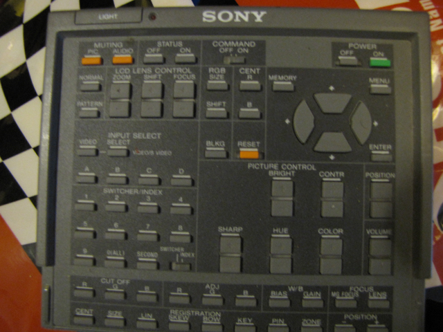

My bad I've got the RM-PJ1000
 Filesize:  237.63 KB
 Viewed:  10573 Time(s)
Ray
I am an iconoclast

Ray
Thanks for your help as well ! Thumbs Up the PJ1000 is very similar!
