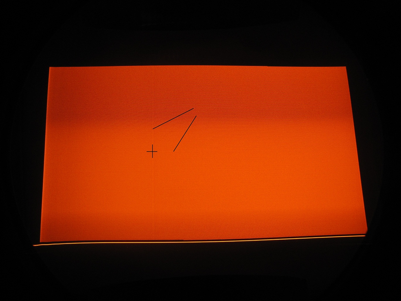

I have a problem developed with my XGLC.
There is a straight white line in the middle of the image, faint but there that has just recently appeared.
It does not matter what signal or input I use it is still there.
Also, if I select all white from the test patterns, a very clear to see cross is visible on the screen. Almost like the cross test patten, but off center and obviously faint, but bright enough compared to the background that it is visible. It appears on all tubes, R,G,B.
I tried disconnecting all inputs as well, removing the moome card etc, but it is still there. It is like the PJ is generating a cross signal all on it's own that shows up everywhere.
Any ideas? Is it aboard issue, some setting I missed?
FYI It is not the AKB line

Posted: Mon May 03, 2010 7:11 pm    Post subject:
If I disconnect the video input cable from the neck cards, then the Vertical line disappears, but the very feint horizontal line stays.
That line stays after I disconnect the cables to the focus yokes as well.
So looks like 2 different issues, or a board that is starting to fail perhaps?
I took a picture of the tubeface with the 'All white' test pattern that shows the problem. Bit hard to see, but you can make it out.

Mark_A_W
Joined: 15 Mar 2006
Posts: 3068
Posted: Wed May 05, 2010 3:31 am    Post subject:
Picture?

Posted: Wed May 05, 2010 3:59 pm    Post subject:
I'd like to see an all white screen picture.
yonexsp

Posted: Wed May 05, 2010 9:51 pm    Post subject:
Not sure about the colour bands running across the screen (camera artifact?).
But the the vertical line means it needs a white balance.

Posted: Wed May 05, 2010 10:20 pm    Post subject:
Why do you say that?
I did the G2 not that long ago, and did the greyscale at the same time.
What did I miss?
Also, I see those bands on the tube face as well, so not a camera artifact, but I don;t see them in a projected image, only the internal test pattern.
