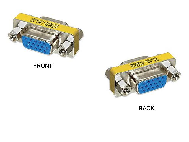

Posted: Sat May 01, 2010 8:48 pm    Post subject:
scooter.125 wrote:
Hi Folks
Thanks for the advice Damien55 and Analogrocks.
Yes it looks like I had it the wrong way round and the fact after you replied Damien55 I checked the body of the Gamma-X and sure enough it says Embarassed INPUT Shocked on the correct side to connect DOH!!! Laughing
However I may not be as daft as Homer because it has thrown up another small issue to which Analogrocks points toward being that the Fury3 has a female VGA end and the Gamma-X has both male and female hence my mistake to try and connect in series; now Analogrocks is correct in that I should use the double ended male connector cable supplied to connect Fury3 to Gamma-X INPUT side Thumbs Up however there is no female-female connect to allow the male end of the Gamma-X to connect to my male VGA cable from the plasma should I have been supplied with that cable do you guys know?
No, we include all six of the RGB cable in the advanced kit. However to make that final connection you will need a female to female gender changer like the one below:
