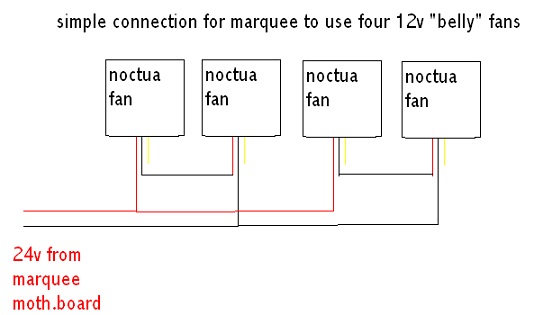

looking for this also?
 Filesize:  30.29 KB
 Viewed:  3336 Time(s)

Posted: Fri Apr 30, 2010 4:24 am    Post subject:
Hi Tom!
Yeah, I remember that thread. That heatsink area gets super hot! I just never liked the idea of doing away with the rear cover. Someday I may explore the idea of fans inside the chassis pointed at the electronics.
Nashou66, thanks - that will come in handy also. Smile
