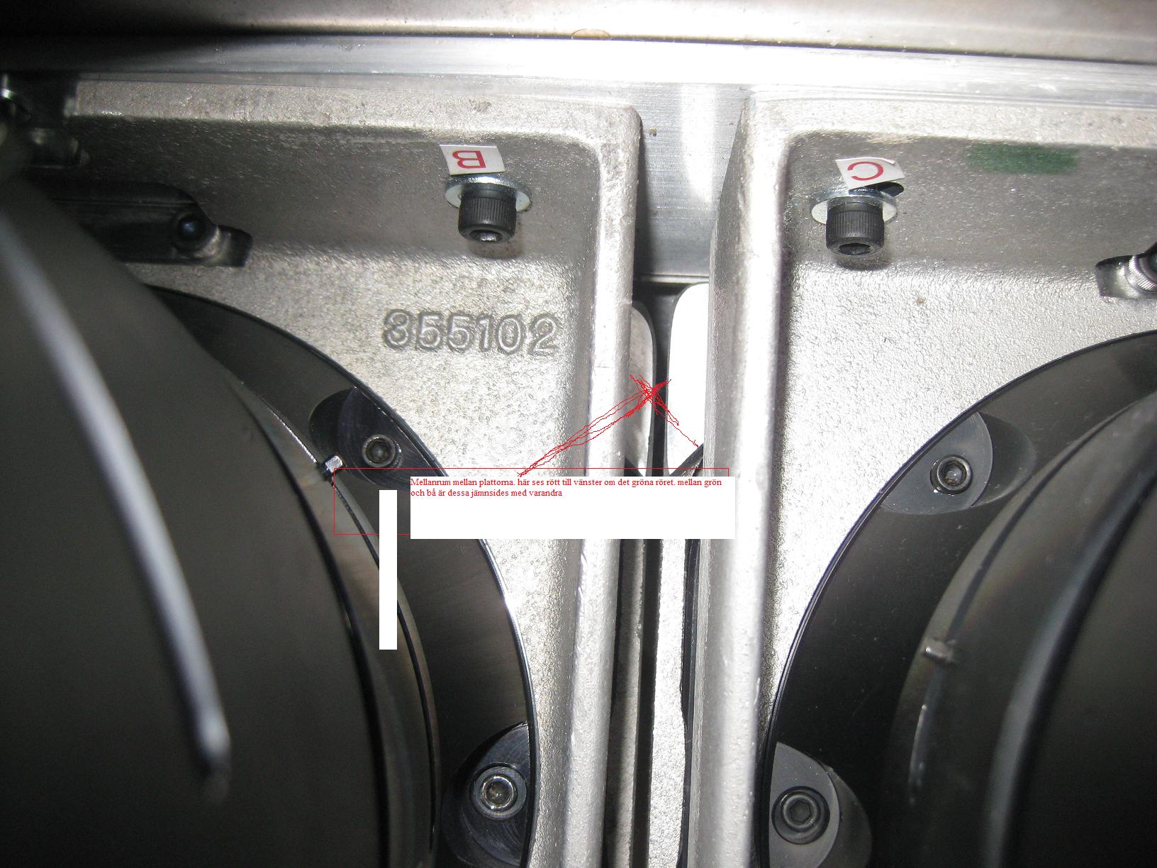

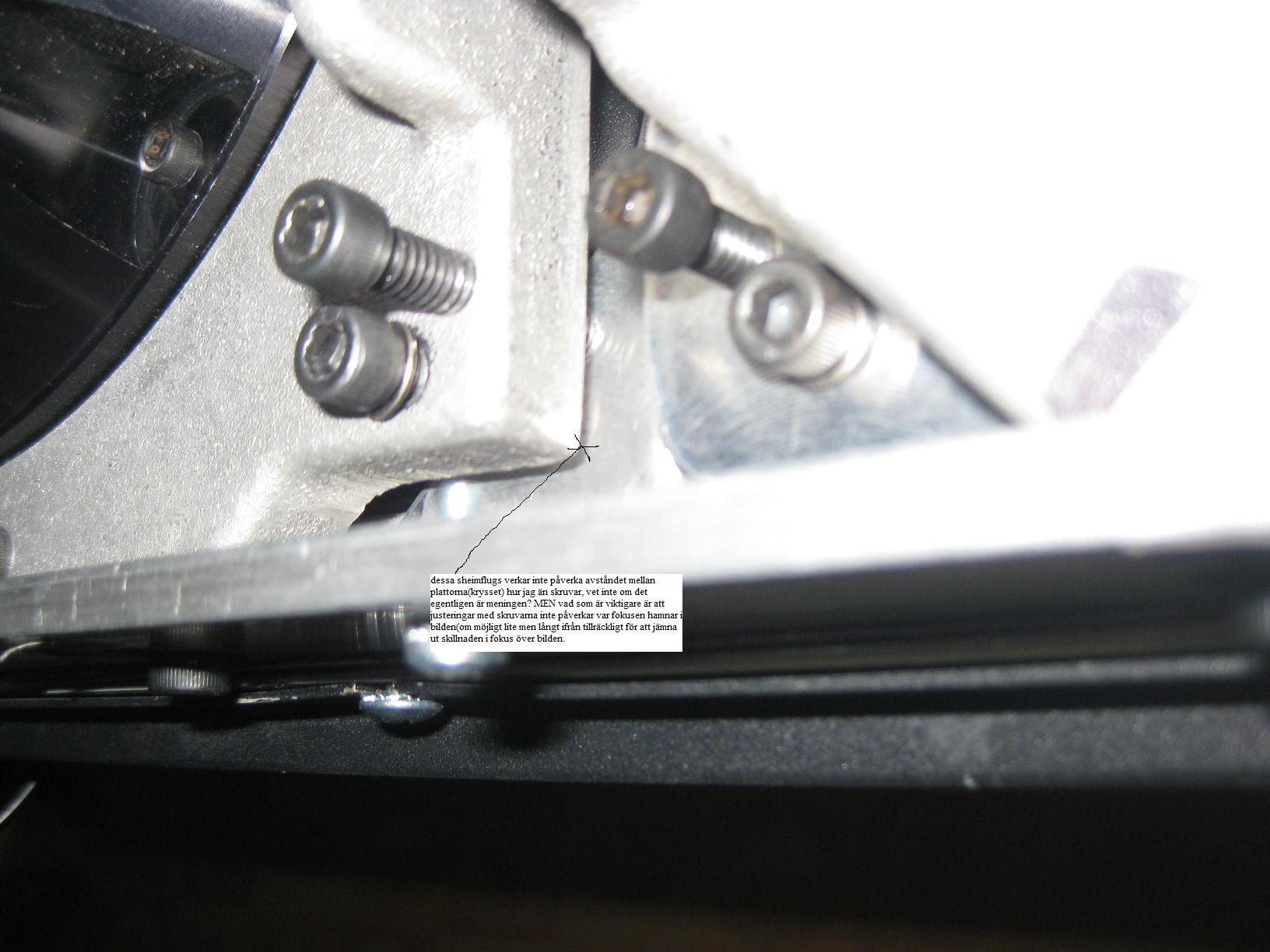

It seems like the flugs on red is not functioning properly. No matter how i turn the skrews, the difference is still to big to get an equally focused or defocused picture. ive tried to move the screen sideways but with no good results. here comes some pictures:
the gap between the plates does not seem to change when turning the flugs, is that normal? but worse, the flugs dont effect the focus enough

gap between plates.
there is a gap between those plates that is obvious. this is between the red and green tube. there is not such a difference between the green and blue. is that normal?

Posted: Sat Apr 24, 2010 2:08 pm    Post subject:
the projector needs to be placed horizontal and the blue and red tube needs to be at an equal distance to the screen.
if placement of the pj is not right its almost impossible to get scheimpflug right (there is just so much scheimpflug can do)
here is my setup this is between blue and green
and between green and red
you may need to turn on the lenses a bit while adjusting scheimpflug. (the front barrel closest to the screen).
if i were you i would put the screws in a somewhat neutral position and start over.
getting the edges to focus involves zone focus and astig too.
if they are too far off you wont get edge focus.

ive tried to move it around/and the screen to) but i does not seem to help. the red lens looks like its equal to the blue but the plate(marked on my picture) seems to be leaning backwards! how to correct that? do i have to take it apart and start from there?

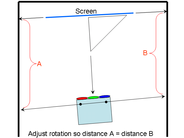

I'm a bit disturbed by your comments about moving the screen around, etc. You should NOT do that. For everything to work optimally, the projector should be ABSOLUTELY parallel/perpendicular to the screen, preferably exactly in the center of the screen. Hopefully your screen is mounted on the wall so it won't move once you've set it up.
Here's a trick to help you line up the projector with the screen:
Sight along two points you know are "square" with the projector, like the projector feet, and note where the line of site falls on the side wall. Rotate the projector until distances A & B are the same. It's very easy to get alignment within a fraction of a degree with this method.

Another possibility is that a pivot pin is not properly seated (or missing entirely) from the side of the red tube. This puts the tube face out of square with the lens.

The pin(s) can fall out when a projector is shipped, or when a replacement tube was shipped. If they are not crimped in properly they can vibrate loose and fall out.
