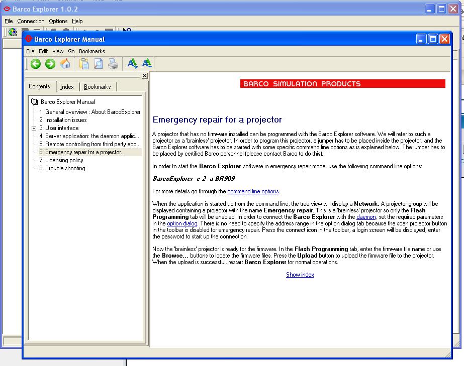

I have a copy of the Barco Explorer programme but never had to use it. It seems straight forwards but If any one has actual experience it would be useful.
I'm not sure where the jumper is for instance there are three on the board
One is definitely SMPS power up over ride
One is marked W1 the other
I can see no marking on the other
Can I take a Cine9 software version 2.21 and just put it into a 909
It is about a 600 mile round trip, SO I want to be ready
Any help would be great

Posted: Wed Apr 21, 2010 10:27 pm    Post subject:
I've uploaded the software a couple of times. Get a hold of Tomas in Sweden, he knows those sets really well.
W3 jumper needs to be jumped. Ignore the other two.
Turn on projector (large square button only), and it should then communicate with the program.
The early version of software was glitchy, version 1. XXX or something like that, but anything over version 2.XXX should be reliable.
Flash the software if you want, otherwise I would simply write this up as a random CPU crash at this point unless it does it again.

Posted: Wed Apr 21, 2010 10:48 pm    Post subject:
Just to be clear by software versions you mean the PJ.
I ask because the explorer version I have is version 1.0.2
Thanks for the heads up the jumper I've got two controller boards here one does not have W3 marked (for others its the one on the far side to the IRIS connector)
