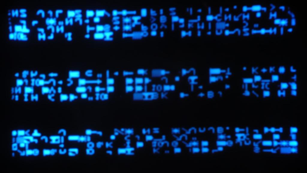

I recently picked up an ECP-4100 and am trying to get it up and running. It has the standard 800916 10 Pin Input Card in Slot 1, and a 38-800930-95 Multi-Standard Card in Slot 0. On power up all three tubes light up nice and bright. Couldn't do a manual focus from 10' distance, or using electronic focus from the remote. Just a fuzzy image of four fat multicolored lines jumping around. Performed a hard reset using reset on remote/CPU, no change. However, with the bright/contrast cranked way down I can see 'alien communications' on the screen. See attached photo for details, it's the same on all three tubes.

Already tried that, unless I'm doing something wrong. The first time I held down the Reset on the remote and then pressed and held the red reset on the CPU PCBA for a few seconds. Released them both and the unit powered down. I powered it back up, same problem. The did the same process using the Recall on the remote and the CPU button, same results. Pretty sure it reset, because the brightness and contrast were much lower when I powered it back up.
Help me Mister Wizard! Think it's the Dallas chip? It has a date code of 9025, so it's knocking on its 20th birthday shortly. If so, where the heck does one find one of these? I did a Google on DS1235YW-150 (that's what's on the PCBA), and all that turned up was a bunch of ads for obsolete component brokers.

OK, try pushing HARD on all socketed chips on all boards. They usually 'click' indicating they moved up a bit in the socket.
You did indeed reset the unit if everything defaults to '5' and the contrast to '3'.

No better, and a new problem. Pulled all the cards and reseated both the socketed DIPs and the socketed PLCCs. Removed card stacks and reseated chips on those as well. Reassembled stacks and replaced cards in their slots. Now the gibberish is less and arranged differently, but still there. Also, now the red gun won't light up. Did hard resets using both reset and recall and no change. Must've really screwed the pooch now Sad ....

Before you put the fork in it, did you clean all the sockets as well when you reseated the chips and boards? Not sure how clean the thing is, but dust does conduct....
~Paul
Posted: Mon Apr 19, 2010 12:41 pm    Post subject:
Check the red CRT socket. One of the problems common on these sets is the video line (2 pin connector) where it plugs into , the motherboard. Those solder joints die often, and they are a PITA to get to. Maybe the red CRT socket just wiggled loose. or you turned the red CRT on/off switch to off?
