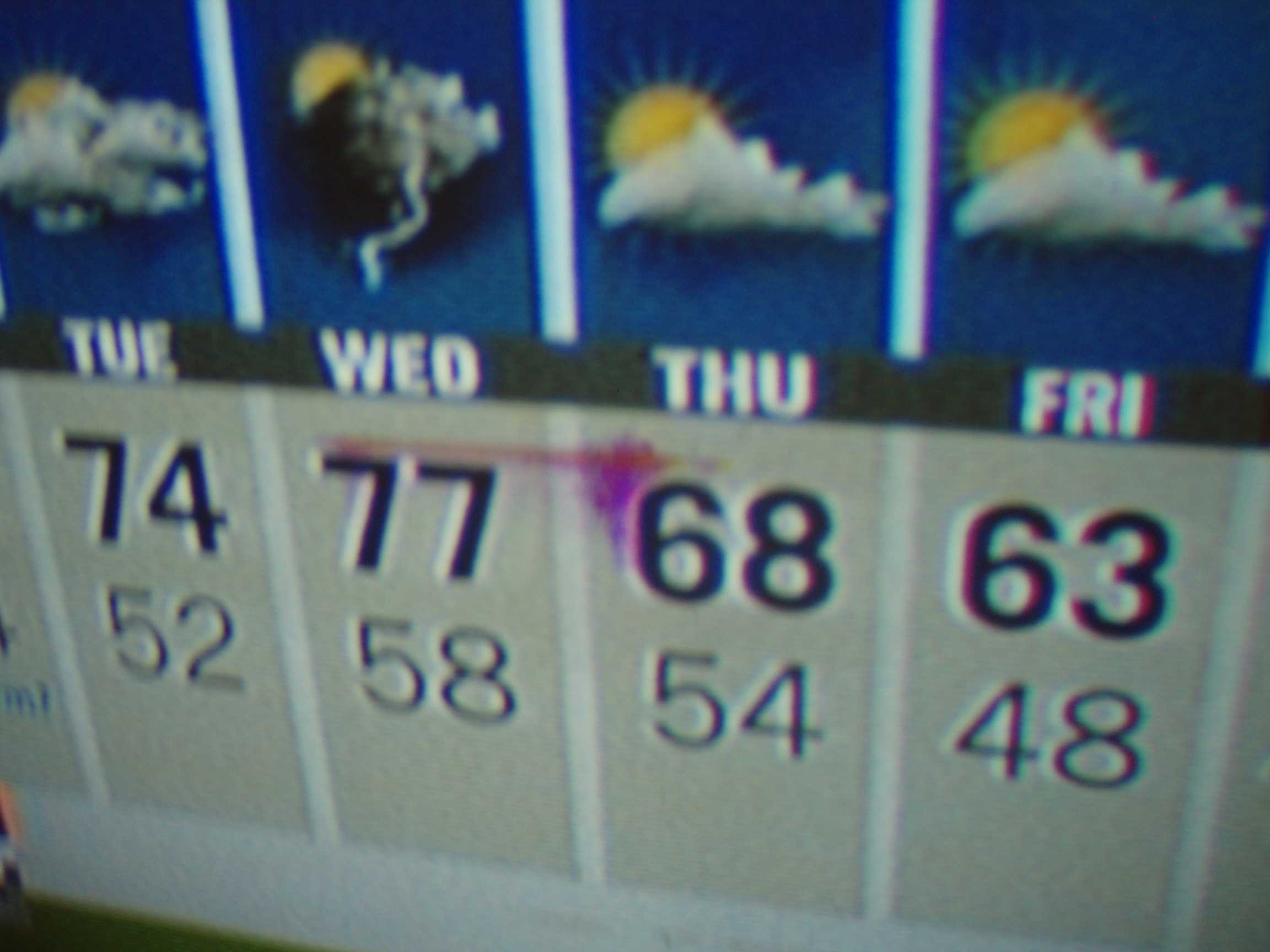

I have had this projector for about 3 months and everything was good until the other night. The picture started flashing in and out and then went to a thin narrow line and started making noises. So I shut it down for a bit and turned it back on to find that it left a big red line mark on the screen.(shown in the Picture) I think it maybe focus block but don't know where to get the new one from. Also is this red line on the screen fixable? and if fixable about how much to fix it?

Unfortunately it's probably not worth repairing. Your V board failed and burned at least the green tube and/or the others. FWIW, that doesn't happen often. The V board is cheap, but the tubes are $200 each. Look into each lens with the power off with a flashlight to see which ones show a dark spot or line in the middle of the tube. More than one tube, and I'd seriously reconsider repairing it, and upgrade to a higher end CRT.
