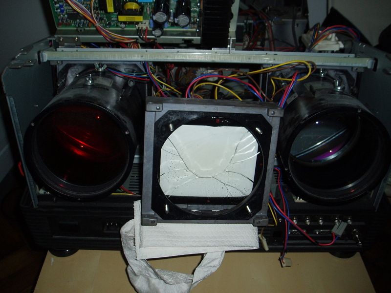

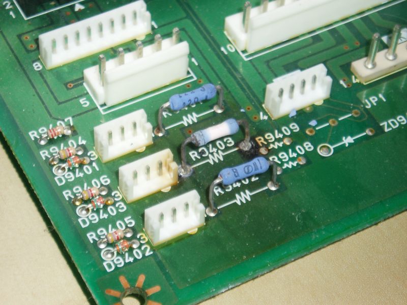

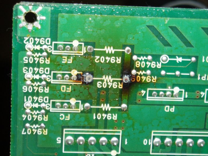

thanks for your answers but i've found the error. the pre owner installed some fan control circuits and anywho the two fan supply wires become loose and made a short circuit on blank metal. so a resistor on the mother pcb burnt away. it's not really easy to remove the mother pcb because i had to remove the green tube and many wires. i didn't get out the hv lead from the hv splitter so i didn't fully remove the green tube and as i work on the mother pcb i heard some crackle, here's a picture Sad
looks like i have to search for a burnt tube and change the glass

That resistor will be the same as the ones beside it, 2.2 ohm, 1 watt.
Now you know why I hate aftermarket mods that aren't done right. It causes problems like this..Sad

Also, I should have a burnt tube, no charge, but it will be $65 or so to ship. Otherwise I could smash the neck of the tube and just send the front part, I'm guessing that will be $35 or so.

ok sounds nice, but i first check if i can get one in europe ... i also have burnt 180dvb22 tubes but think the glass is to big
Curt, you sure on that 2.2? I'm showing 22 ohm. Smile

i can look that up in the service manual or measure it, no problem.

Bleed your other tubes.
Changing the glass isn't hard, just time consuming.
Use turps, drain the glycol on the donor tube, and fill the chamber with turpentine.
Wait a day or two.
Cut the glass off CAREFULLY with the thin razor blades with a folded backing edge. (For paintscrapers.)
Just use regular black acetic cure silicone (the vinegary one) to reattach the glass.
And you pry the HV boot up carefully by lifting and pushing the edge of the boot - it pops over a ridge and is hard to remove. Use the round shaft of a screwdriver (not the tip) and don't scratch the splitter, or the HV will come out and it's REALLY LOUD!
Actually I was looking at the pix, and seeing that the 2 and 2 were so far apart, it looked like there would be a . between the two.
22 ohms it is!
