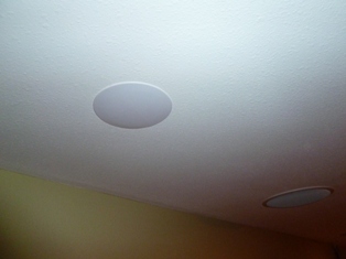

I've used Wallo spring loaded round access panel for similar project last month:

Posted: Thu Mar 29, 2012 8:53 pm    Post subject:
I've never heard of them. Where did you buy them?
ThomasR75
Joined: 29 Mar 2012
Posts: 2
Posted: Thu Feb 13, 2014 12:15 am    Post subject:
They come in 4.75" and 9" diameters and available on amazon and from http://www.drywallaccesspanels.com/ Thumbs Up
