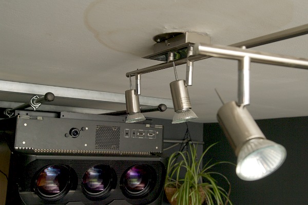

Posted: Wed Jun 09, 2010 7:24 am    Post subject: A close call!
Well, the projector has been working perfectly although I haven't really used it much lately. I still don't have the screen cut and mounted.
That aside, last week with the sun beaming in on the black leather couch I thought the cushions were expanding and rubbing against each other. Anyone who's ever sat in a leather/vinyl piece of furniture will know the sound I'm talking about. I didn't think anything more than that but thought it odd as it never made that noise before. I soon discovered water dripping down through my light fixture on the floor.
I first thought, Oh NO, one of the 6 lag bolts I put up last year eventually made a water pipe leak. The logical explanation was that the new upstairs neighbor has a leaking tub/shower surround. I went up and checked and it turned out to be an old O-ring on the cold water hose for the washer which they moved in about a month ago. A steady drip from the faucet and on the floor behind the curled up vinyl flooring, through the wood, insulation and drywall.
A little bit of sanding, plastering and paint should make it look good again. I meant to repaint the ceiling anyway. I really need to put the projector on the apartment insurance though.
