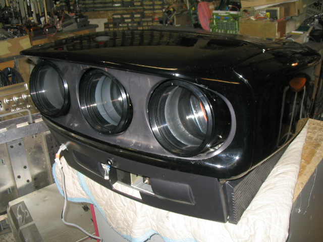

Posted: Mon Feb 08, 2010 7:25 pm    Post subject:
a couple pics of ACON front trim piece

Posted: Mon Feb 08, 2010 8:53 pm    Post subject:
Thanks guys
Okay, so it is not only me that thinks they fit awful together. The worst part is actually the Acon cover. I will bring out the heavy tool and change it until it fits. Then I will have to find a way to mount the IR receiver and the Acon afterwards.
I cannot get the Acon front piece up below the front of the Vision case (because of the alu holding the plastic thing that hold the connector for the Acon) and it cannot go on the outside of the front of the Vision case either.
