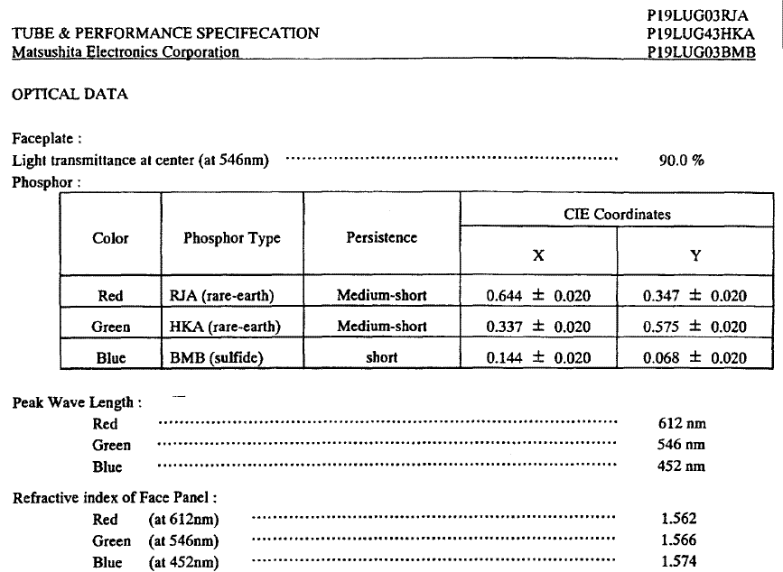

Posted: Wed Feb 03, 2010 12:43 am    Post subject:
The persistance of the blue phosphor is very short. The ghosting problems should be much less with blue if persistance is the problem.
Scott
 Filesize:  26.38 KB
 Viewed:  15087 Time(s)
