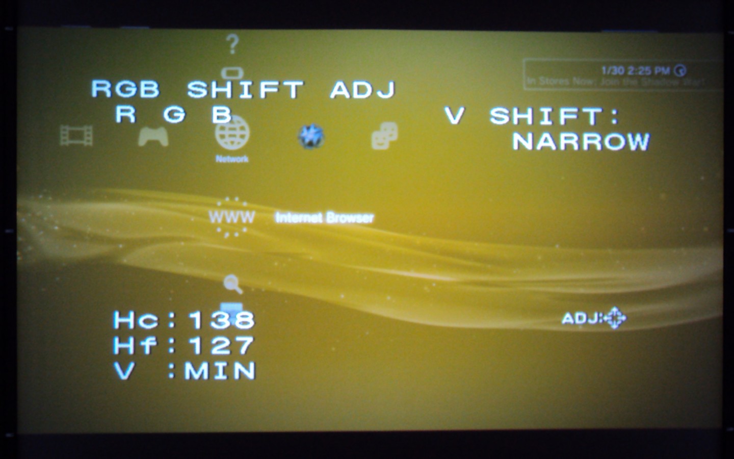

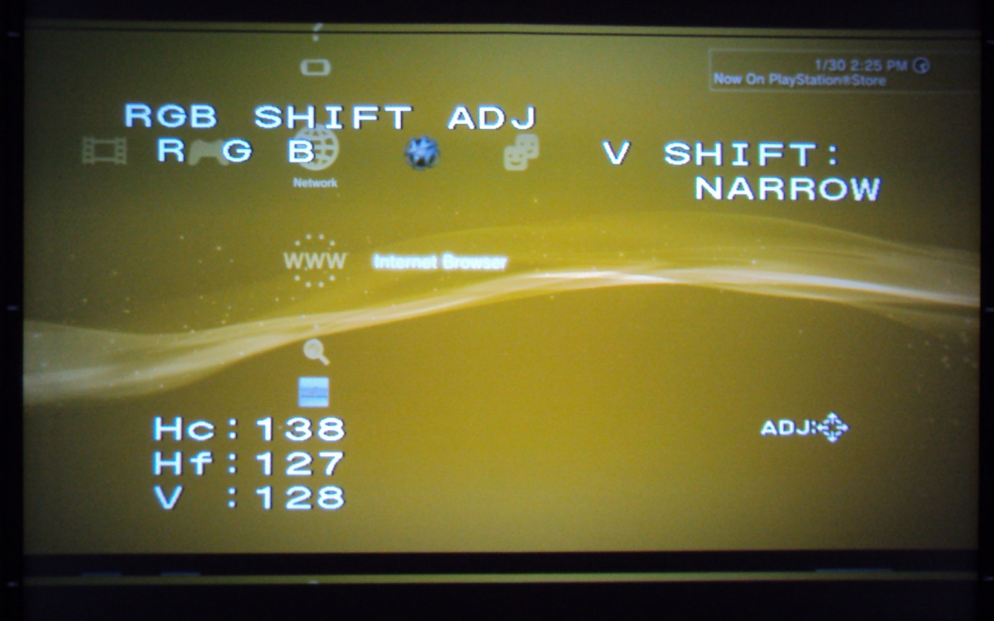

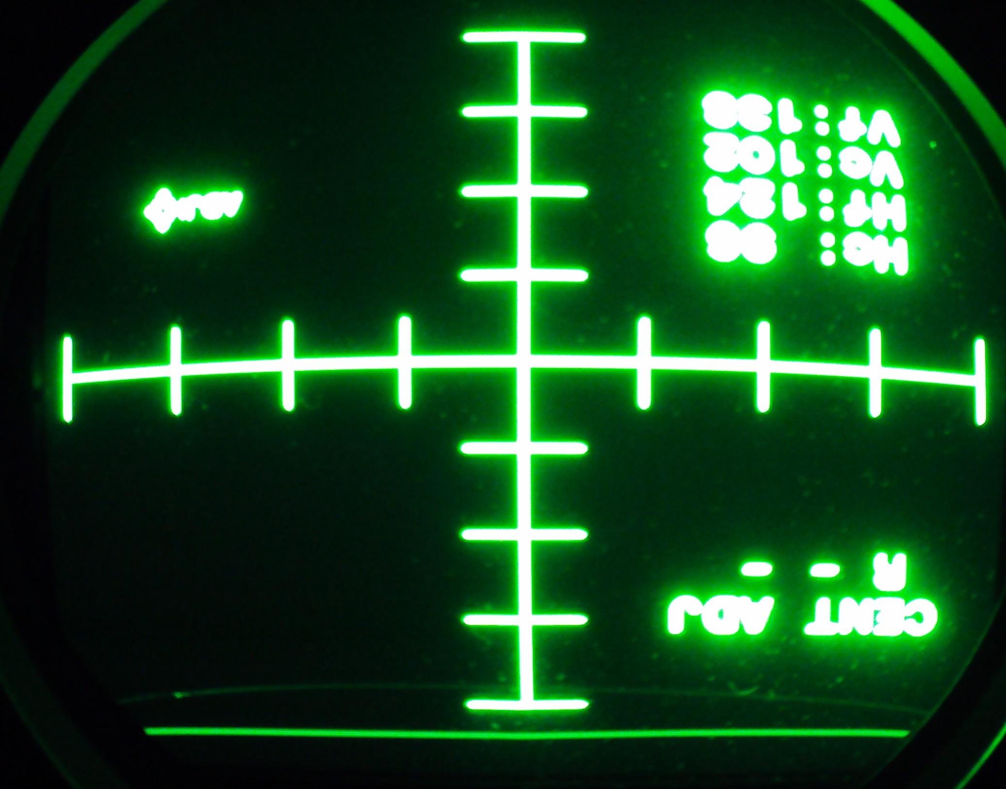

I've had this problem since day one with my G70. It wasn't much of a big deal to me until recently when I got my raster perfectly centered on the tube face and no longer want to tip toe around it by adjusting my throw or my raster position off center to compensate.
On each tube there is a straight bold line and a much fainter arched thin line at the top of the raster. It appears whether a source is connected or not. On screen only the bold line is visible as a faint grey line at the top of the image. If I move the active image area into this line it cuts the image off and any scan lines that pass it end up on the bottom of the screen. In contrast to my well centered raster, the active image wants to show up well above center. I have to adjust RGB shift all the way down to get it close to the center of the screen. The only way i know of to get RGB shift close to mid range would be to throw my raster off center or adjust my projection angle and i would rather not do either.
Here are a few pictures. Does anyone know what this is?
 Filesize:  159.45 KB
 Viewed:  5168 Time(s)
 Filesize:  162.37 KB
 Viewed:  5123 Time(s)
 Filesize:  156.83 KB
 Viewed:  5099 Time(s)
green tube with the lens off
 Filename:  DSC00026.JPG
 Filesize:  374.59 KB
 Downloaded:  364 Time(s)
Posted: Sat Jan 30, 2010 10:20 pm    Post subject:
Yep, that's the AKB line (Sony calls it ABG).
There are lots of references to it in many threads, including some posts by me.
Here's the one thread I could find quickly - lots of info:
https://www.curtpalme.com/forum_archived/viewtopic.php@t=10881.html

Posted: Sun Jan 31, 2010 1:01 am    Post subject:
Ok, SO turning ABG off got rid of the lines and made the picture markedly dimmer, but this did nothing for the RGB Shift adjustment issue. The image will still clip if it is adjusted up to where the AKB line was and it is still no where near centered without adjusting RGB Shift all the way down. I also realized that since I have my projection angle on a zero axis (parallel with the floor), increasing the throw distance won't make any difference on the position of the center of the image. It will stay constant. I just don't understand why the image wants to be so high up!
Here is the video chain: PS3 on component - RTC2200 - G70 through RGBHV running 1080i. I backed off all the turnpots on the RTC2200 but there was no effect.
Any Ideas?

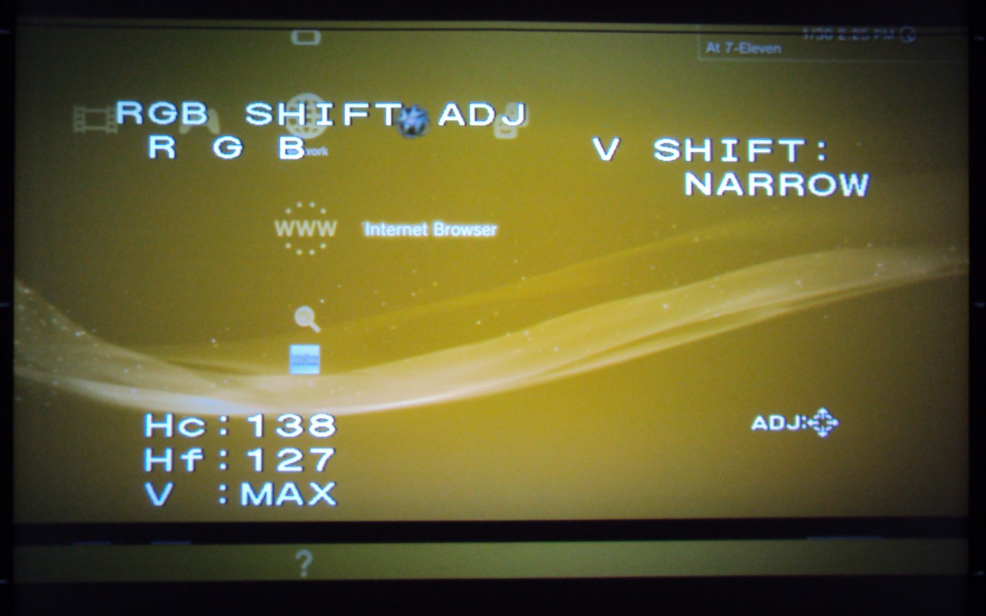

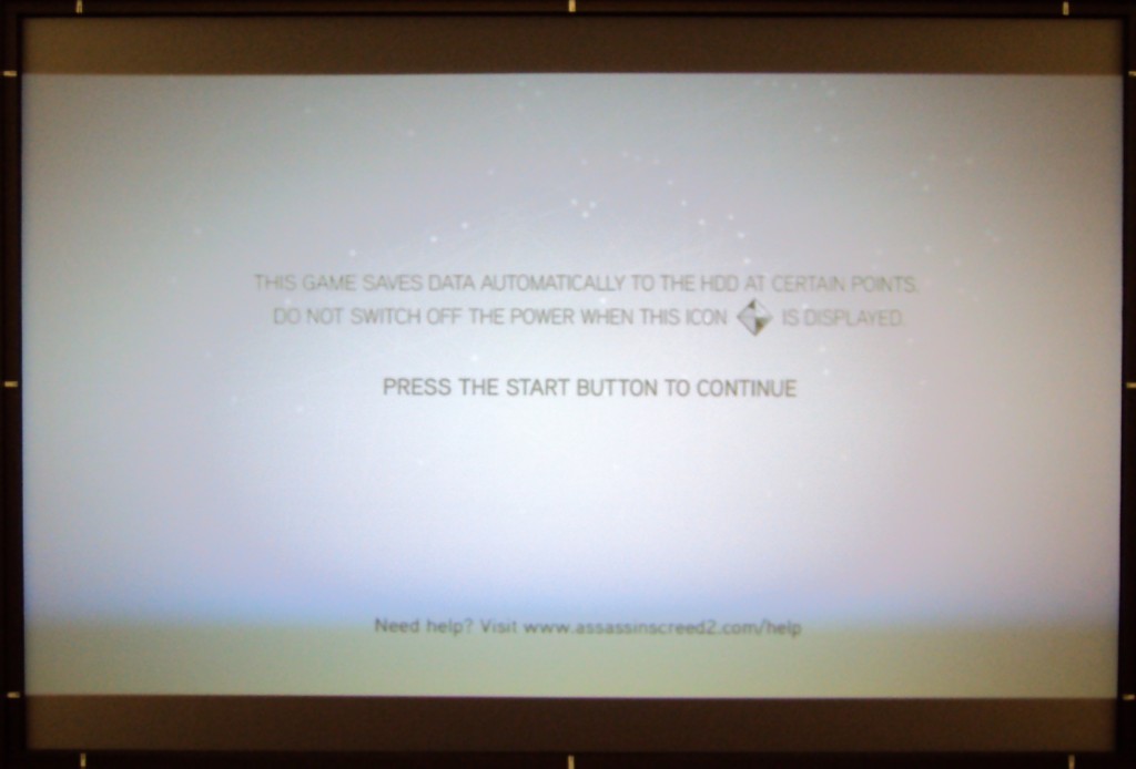

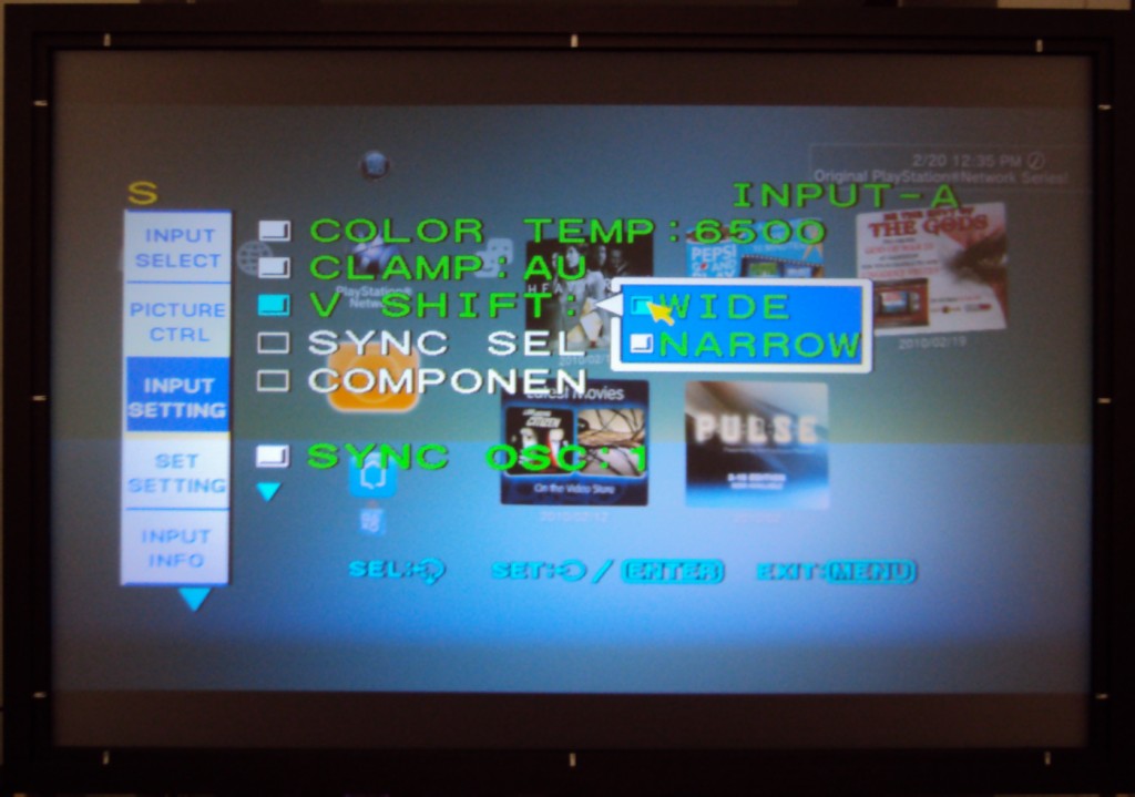

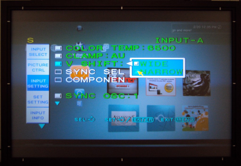

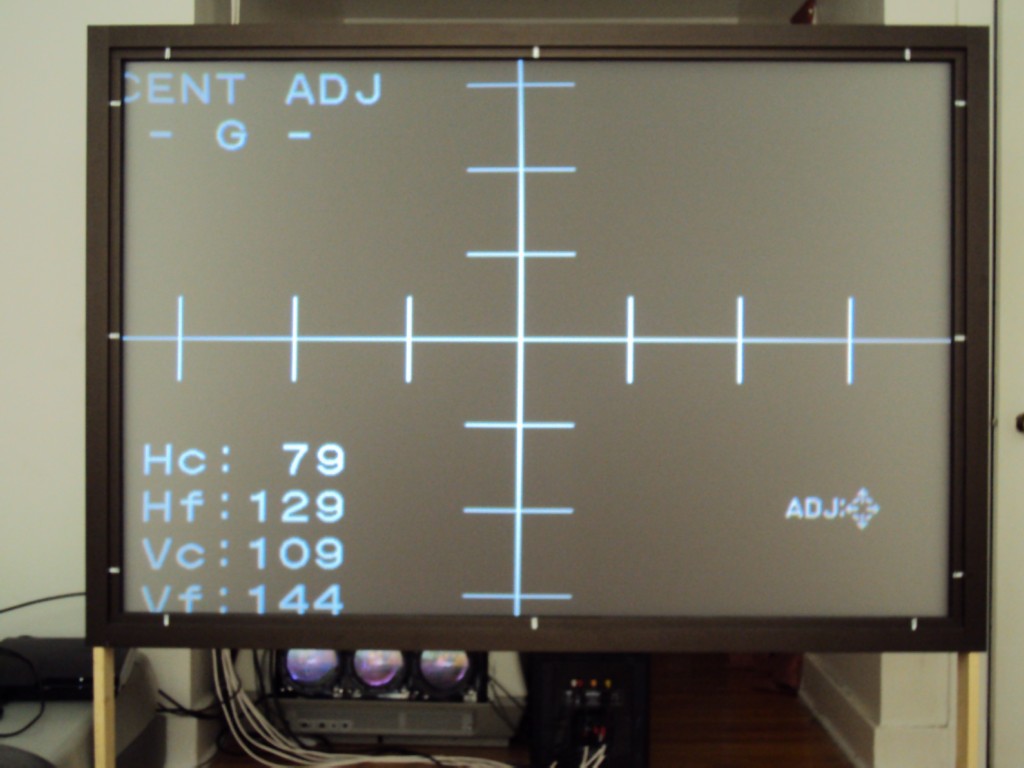

Below are a couple of pictures to illustrate. Sorry the image quality isn't great. I took these in daylight.
Ringing Gone! Very Happy
Ringing Gone!
 Filesize:  69.91 KB
 Viewed:  6461 Time(s)
Current raster position
 Filesize:  98.81 KB
Just switching to narrow makes the image clip at mid range
 Filesize:  107.98 KB
 Filesize:  108.8 KB
CIR Engineering
Joined: 25 Aug 2008
Posts: 4269
Posted: Sat Feb 20, 2010 10:00 pm    Post subject:
Nice work.
However you are still doing something wrong. The throw distance has nothing to do with the raster ringing or image position. Position the projector to maximize your phosphor usage as you had done in the past. Then just use the center adjustment to put the image in center.
The size adjustment increases both the image and raster sizes together. So if you increase the width the image should stay the same distance from all sides of the raster and you should not get any more or less raster ringing no matter where the projector is positioned.
Am I making sense?

CIR Engineering
Joined: 25 Aug 2008
Posts: 4269
Posted: Sat Feb 20, 2010 10:02 pm    Post subject:
Maximizing the phosphor usage on 8" machines like the G70 is absolutely critical so you must do this right. A g70 can come close to fully resolving 1080p 60Hz if you set up your image to use the entire tube face. Ever millimeter of wasted tube face will result in loss of resolution and you don't want that Wink

Kiev Savoie
Joined: 25 Oct 2007
Posts: 432
Posted: Sat Feb 20, 2010 11:25 pm    Post subject:
Ok, If i understand you correctly I can put the throw back up to the 82" which i used initially. With size and raster maxed out I had a 1080i active image area almost touch the tube face sides (equal to or less than 1/8" clearance) and just barely fill the screen with about a 1/2 inch of adjustment to spare. I had trouble with 720p filling the screen, as you may recall, but that is what the VP can help with, I suppose. Then all i have to do is move my raster off center and adjust the shift setting to recenter the image and perform a few geometry corrections to get a nice ringing free picture? I think i'll start moving my screen back right now.
Thanks!
