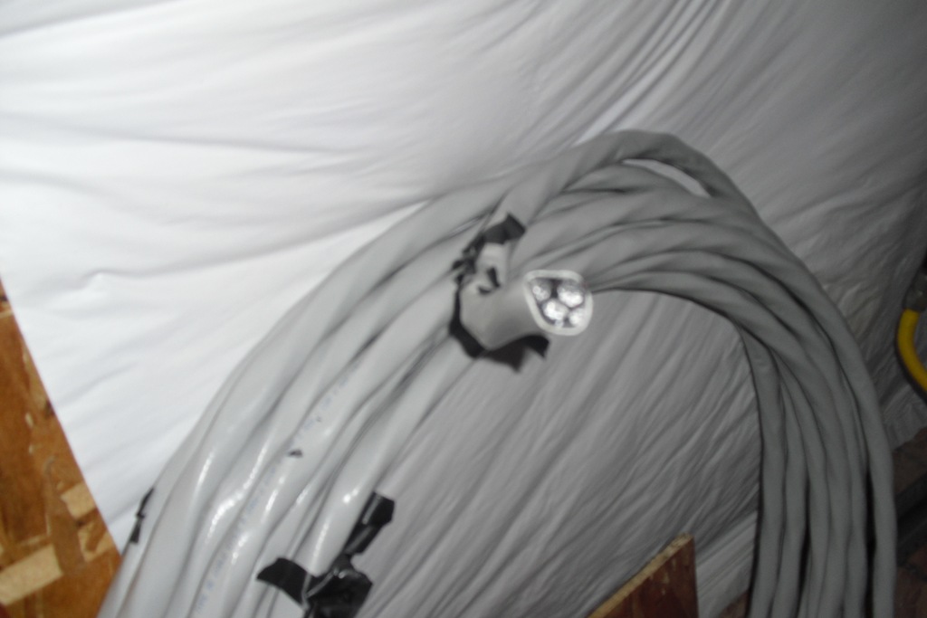

WamMan I will definitely ask him about that. Right now I have a real hum dinger to deal with and that's trying to figure out a way to get this thick cable through this little old conduit that was left behind. At a first glance I thought it was go...now that I have the cable on site...well it just doesn't look good for the team today. Oh btw it's ran through the concrete of my foundation Shocked Wish me luck!!!

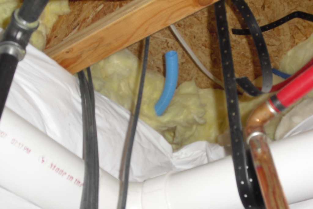

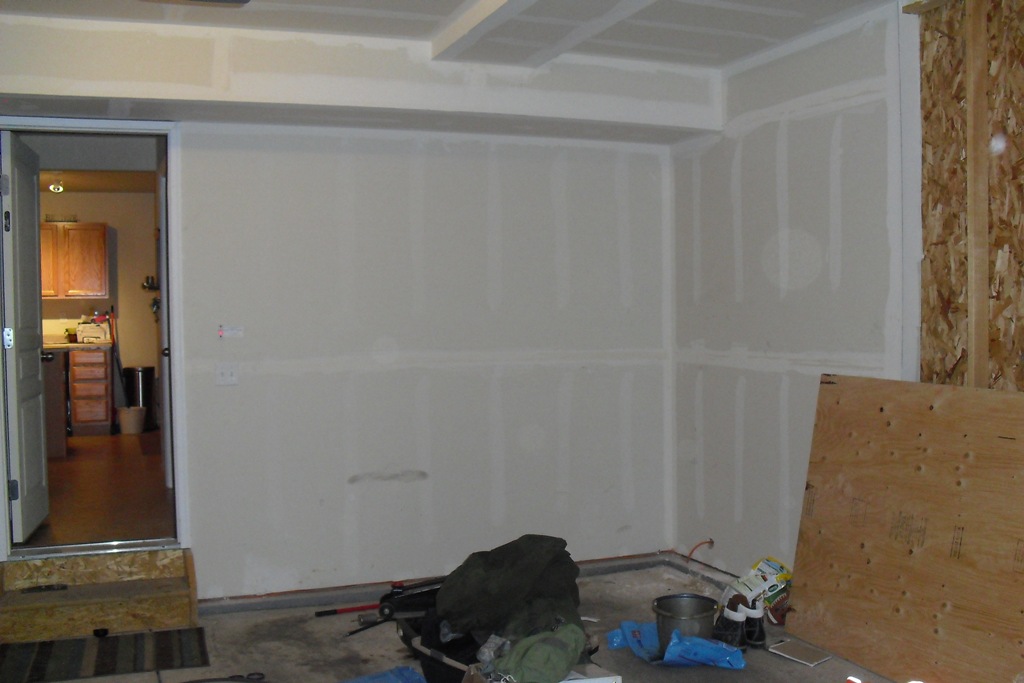

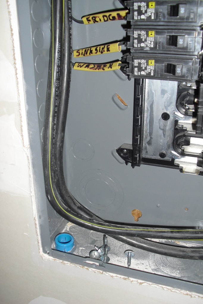

Well before I call it a night, I thought I would post some pics as to my situation. The main panel and blue condiut for my new run are first. As you can see it looks smaller and it actually is smaller than the cable. Yep NM sheathed..you guys are to good for me. As far as running it outside (really don't wanna do that) it may be my only option for this size of a run. Unless I can get away with running it through my garage...I tested a 10-2 wire to see if it was possible and I got good results. If I build a soffit for it..is this doable?
And of course you see why I can't use the conduit because of the size.

Here is the tube where it terminates downstairs from the main.
 Filesize:  167.58 KB
 Viewed:  14768 Time(s)

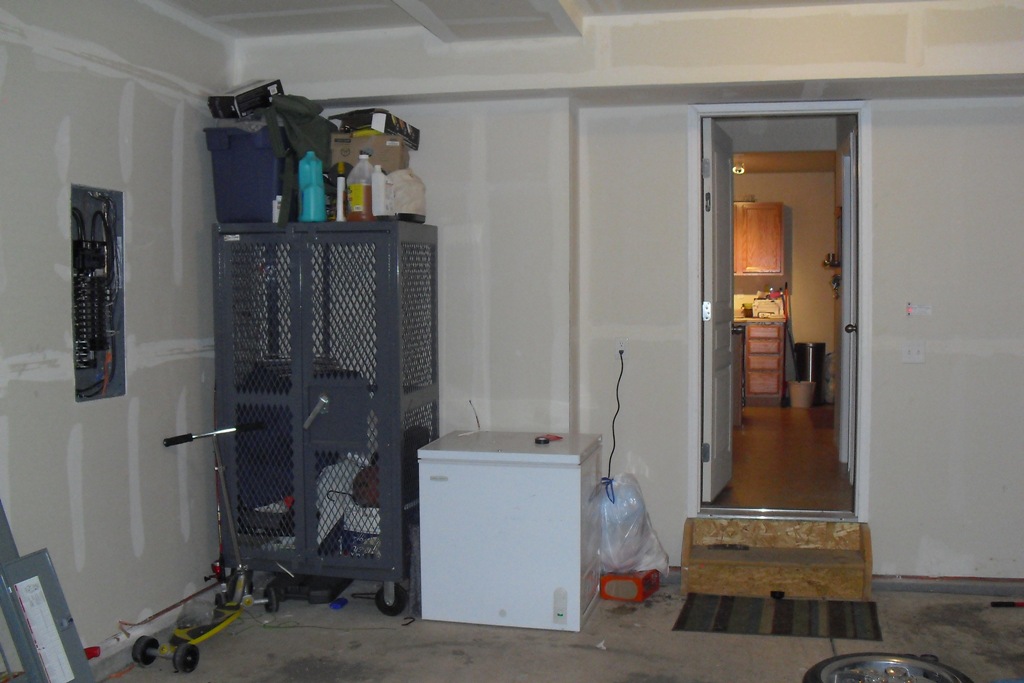

Across the garage to a hole that I drilled...the penl is righ ton the other side of te wall about 4 ft below.
 Filesize:  180.73 KB

Now I assume I can run the 4-3 from here to the basement inside as long as I keep it out of the way of traffic?
 Filesize:  197.3 KB

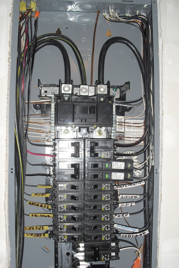

This is the full pic of the main panel
 Filesize:  295.74 KB
Main Panel (blue tube is conduit)
 Filesize:  234.06 KB
