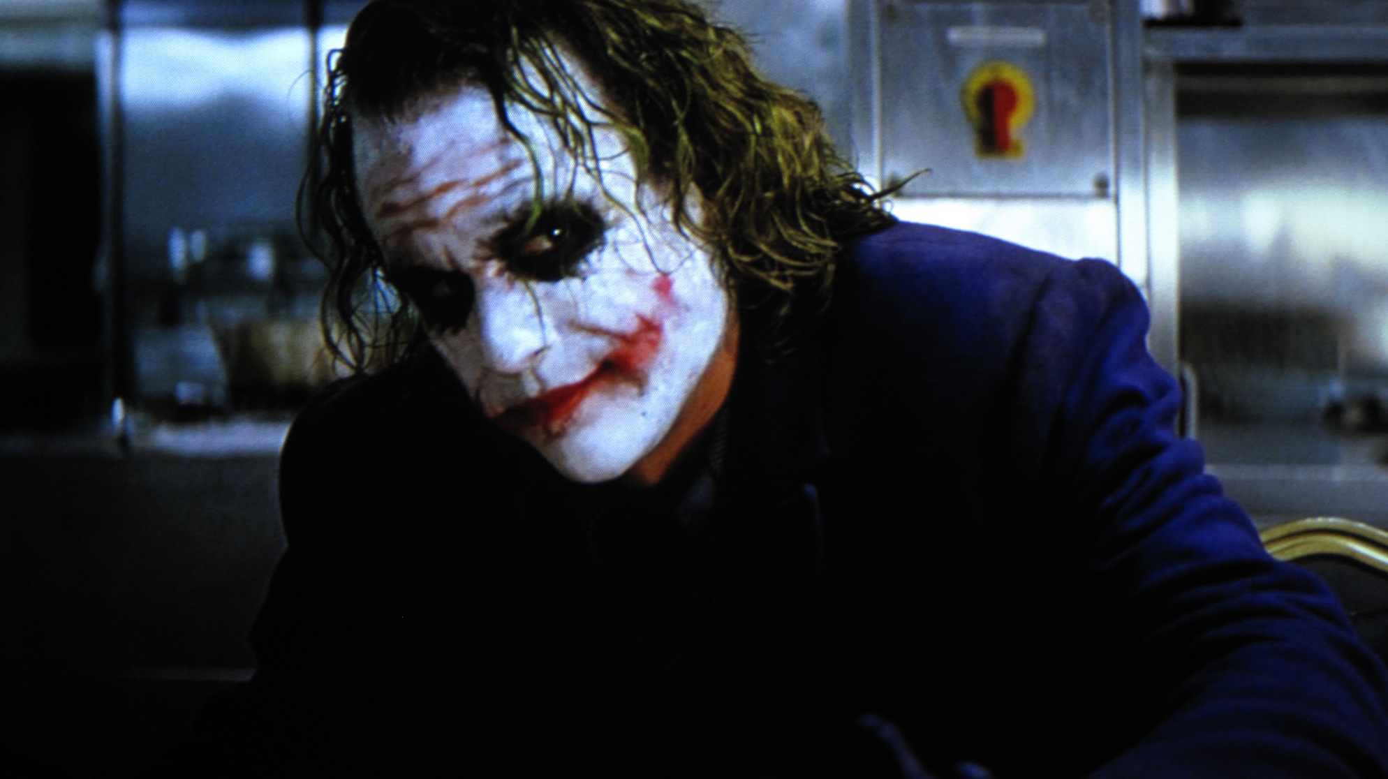

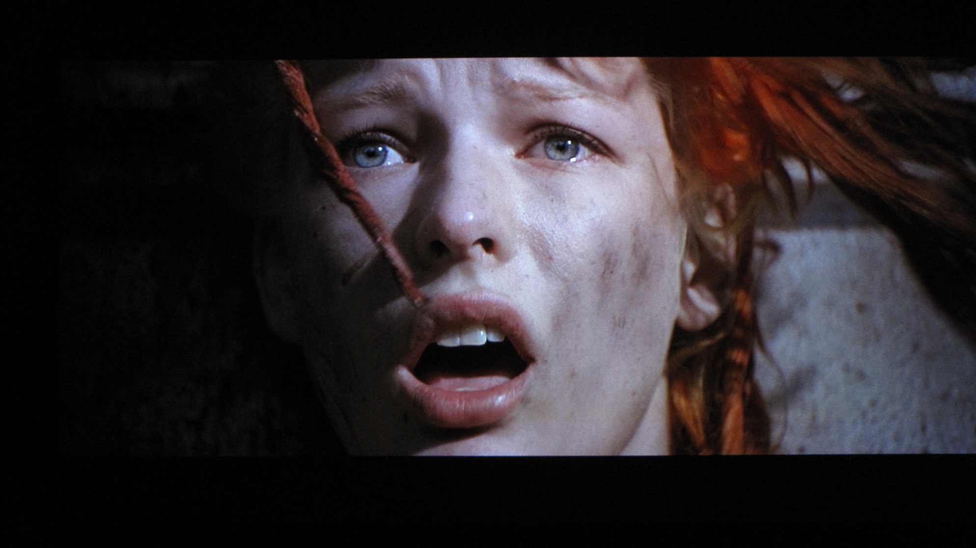

I've added some images I snapped last night. These are from Blu-Ray discs in my Media Center PC using TotalMedia 3 player. Clearly I now need to go through a full calibration of the projector - but it's not unwatchable right now.
Oh, quick question - any tips on setting the contrast and brightness? They are currently parked at the factory defaults. Is there a particular test pattern or content that I should be viewing when setting these?

To Set the G90's Contrast and Brightness, The easiest way is to use A Blu-Ray such as DVE HD Basics or DVD DVE these contain the
test patterns needed...
Because You have your Contrast and brightness set to factory Default, unless you are running A Large screen,
I think its safe to say that You will be wearing your tubes out much faster/ unnecessarily running Contrast at 80...
