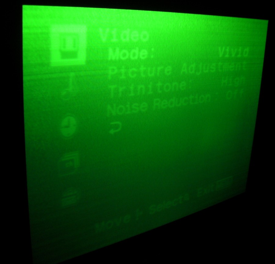

Ok done playing for the night. Everything's green.
The menu's are all green, the quick focus was green only. The neck cards are glued in place so I'll have to try chipping away at it if we want to swap neck boards.

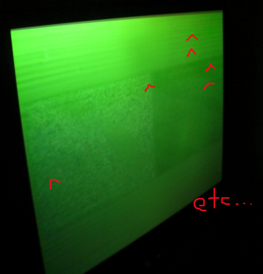

The green also has a diagonal retrace lines that are arced back and forth across the screen:

I need very specific answers.
1: Does the green display clear video?
2: Is there sound?
3: Is the menu clear?
4: If menu is clear can you go into the menu and look for an adjustment screen for red/blue and does it bring up a cross hair?

Posted: Tue Jan 05, 2010 4:03 am    Post subject:
2: Is there sound?
1: No, the green's very washed out.
2: Yes, the sound is perfect
3: No the menu's not very clear at all.
4: I can't enter the setup. It keeps telling me to connect the TV cable even though it's already connected.

Here's what the menu's looked like.

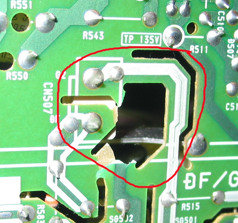

OK I poked around as per Mac's instructions. Those capacitors look ok. However I couldn't find any of my 5 DMM's Laughing So I'll have to test them later.

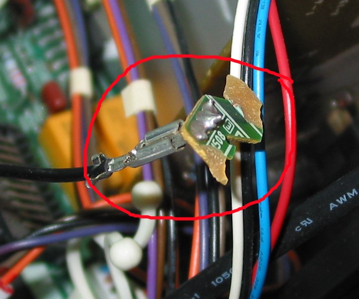

I did manage to snap a piece of the power supply board off though damit! There's a really tight spade lug in the middle of the board I pulled and wigled, wiggled and pulled. Then the board snapped.
The hardest connector was on a peninsula part of the board with a moat machined around it. 1/4 inch or board holding on one end and 3/8" of board on the other. Stupid design.
SO I have to fix that too. ( grumble...sony...grumble ) Rolling Eyes
