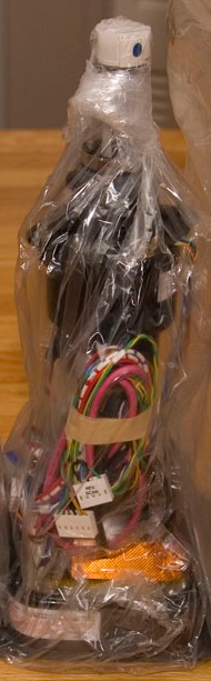

I finally have a new blue tube for my 8500. I haven't replaced a tube in my projector yet. I have looked over the tube replacement procedure posted here (from the NEC XG manual), but I was hoping for something 8500-specific.

It's a new tube with all magnetics and focus coil already in place.
