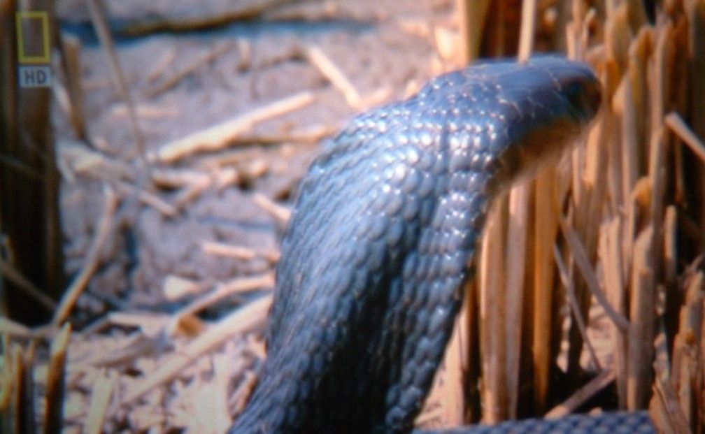

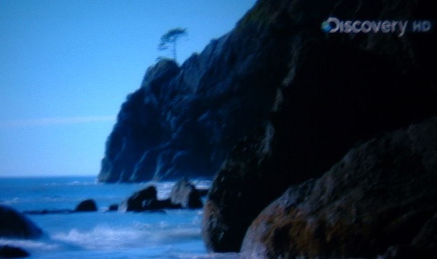

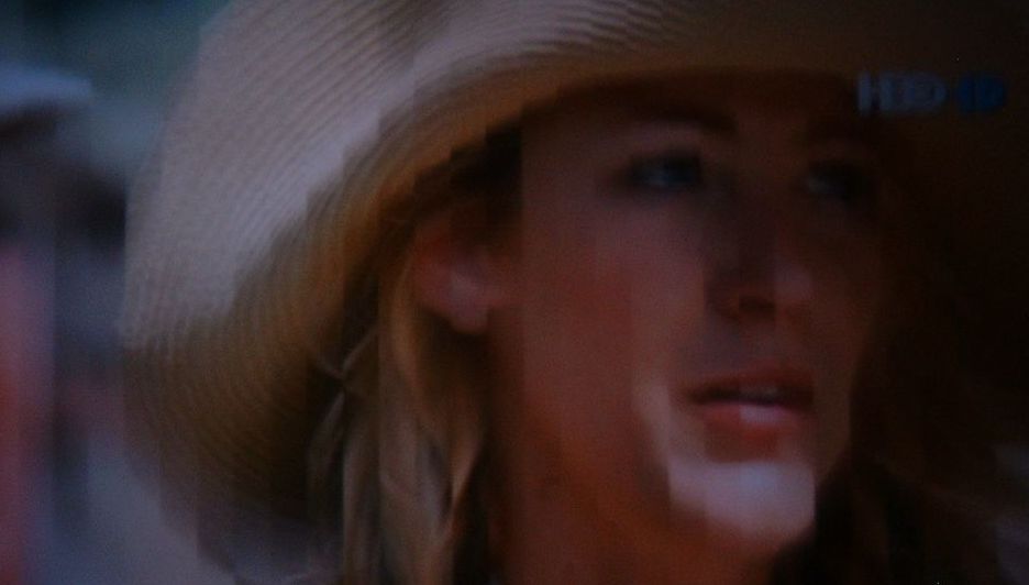

Posted: Fri Dec 18, 2009 2:02 pm    Post subject:
I've taken some photo for the V1 card to show that the picture is good and perfect without any distortion.
After which, I removed V1 card & re-seat V2 card and start to 'ON' the projector.
The picture for Bluray is very impressive with the V2 card but unfortunately, my HD Set-top box is still compressed.
I took out my HD set top box and try to put as close to my projector and using a 3 meters HDMI cable and connect to input 1 on the V2 card. Again, the picture is still compressed. With this test, I believe the V2 card is faulty now because there is no problem at all with the V1 card on the G70.
Regards
Faizel
