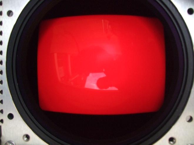

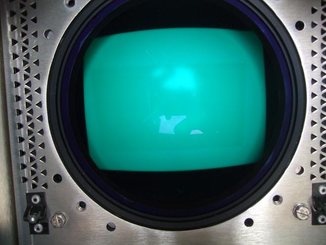

OK, I went by and took a look at this pj today after work. Attached are pics of the green and red tubes. The guy said he got to the menu a few months ago and thought that the hours said 3900. I could not get into the menu screen. Either there is a problem or I do not know what I am doing. When I push standby on the remote it makes the noise like the tubes are firing up and the fans come on but nothing on the tubes. I press the adjust button alone and followed by enter and still nothing. I connected up my pc with a 5 bnc cable and still nothing. I took the cover off and looked in on the tubes and the little black box on the rear of each tube has the green led on. This pj has the auto adjust camera on the front. Is anyone interested in any parts from this. If I get enough interest I will go back and pick it up.

I sent you a PM, I'd be interested in the G2/DIAG board, SMPS and Horizontal Shift/Focus boards if they are not already spoken for. Those are all bad in the spare projector I have. It sounds to me as if it is going in EHT holdown.
Edit: Too bad on green, typical Runco putting the set too far back.
