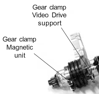

With s-model this is much easier, because there is neck board support. Place magnets almost against it and start adjusting astig...

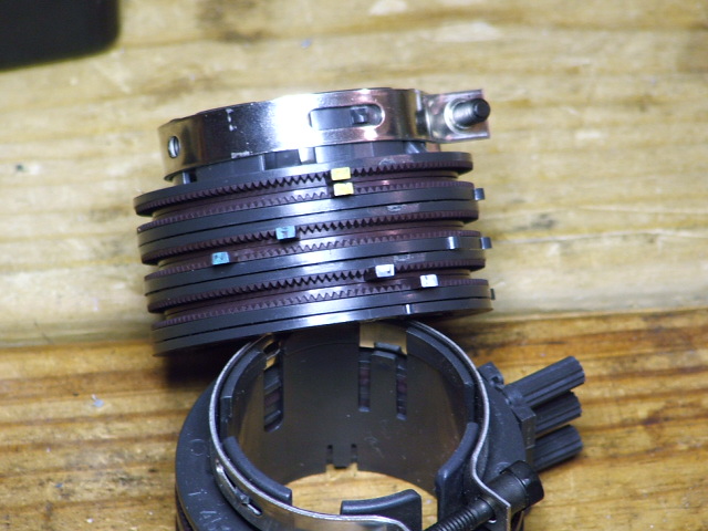

It makes things easier if you "null" the neck magnets by overlapping the tabs like the yellow tabs in the attached pic. Get your focus mag positioned like in the procedure then adjust the stig and flare with the neck mags.
Scott
