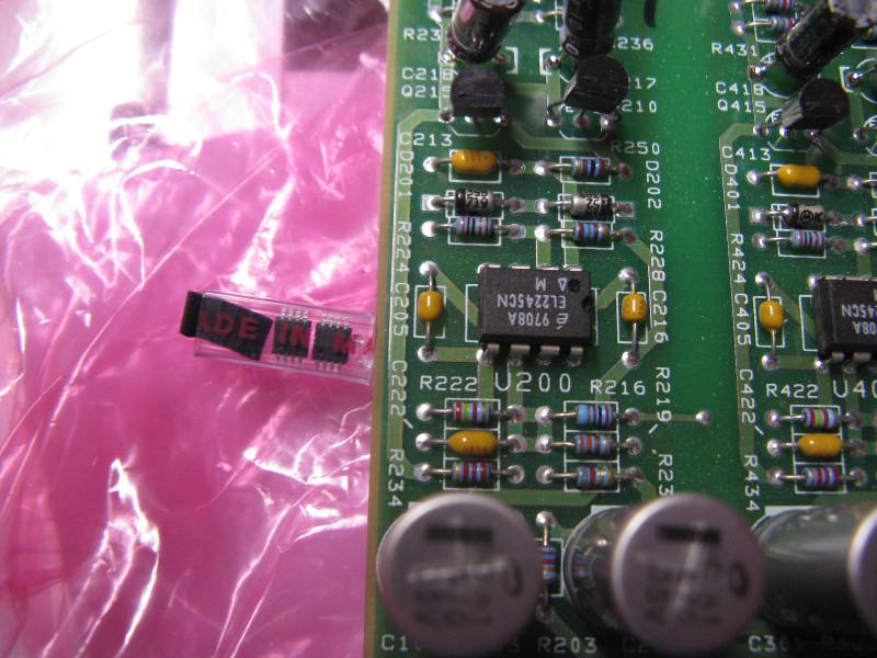

Posted: Sat Mar 27, 2010 4:05 pm    Post subject:
Never heard back from steve but doing some quick research I think this chip might work:
http://www.intersil.com/data/fn/fn7058.pdf
http://www.mouser.com/ProductDetail/EL2227CYZ/?qs=2VKgqYuc3OtW9NqIU4REvA%3d%3d
oops, that's not it
 Filesize:  74.32 KB
 Viewed:  6047 Time(s)
Posted: Sat Mar 27, 2010 4:20 pm    Post subject:
Ooops is right, i forgot it was the dip version not the SOIC. Sorry drags, thought you would double check.
Athanasio
Thats why those data sheets are so handy. It indicates they are not the same style.
Cant say I haven't made the same mistakes before also. I'm very cautious myself anymore. Very Happy
Posted: Sat Mar 27, 2010 4:25 pm    Post subject:
http://www.sierraic.com/pnresults.asp?part=EL2245CS
edit: scratch that. it has to be a CN
Posted: Sat Mar 27, 2010 4:37 pm    Post subject:
any chance of jumping the legs over to the through holes with fly-wire?
Posted: Sat Mar 27, 2010 4:55 pm    Post subject:
http://www.sierraic.com/pnresults.asp?navpart=el2245cn&r1=4

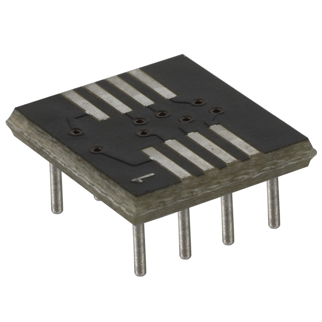

Posted: Sat Mar 27, 2010 6:17 pm    Post subject:
Fly wire would work. Keep them short.
Check to make sure the pin-out is the same and if it is something like this can be found, search for msop to dip adapter.
Scott
