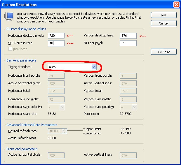

Step 1:
Right click on your windows desktop and select the "NVIDIA CONTROL PANEL"
Step 2:

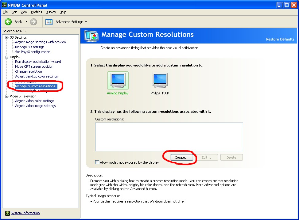

Once in the Nvidia Control panel select
Manage Custom Resolutions from the left list. Then click on the "Create" button on the right side.
Step 3:

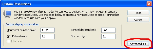

Click on the "ADVANCED" box
Step 4:
Enter the "Custom Display Mode Values" in other words your screen resolution. 720, 576 and 48

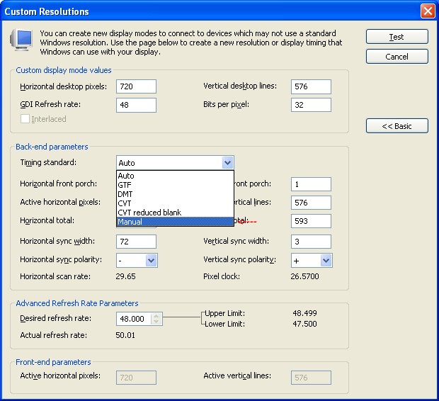

Step 6:
Scroll down the timing standard list and select MANUAL

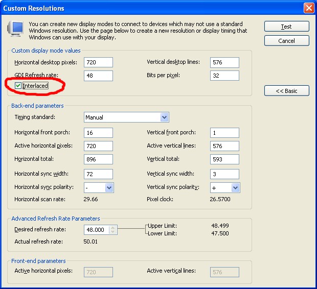

Check off the INTERLACED box

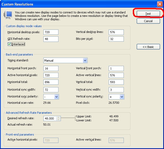

Now push the TEST button and see what you get on your screen.

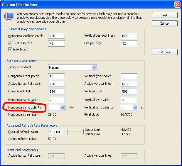

You may need to adjust the horizontal and vertical sync polarity

Enter the "Custom Display Mode Values" in other words, your screen resolution 720, 576 and 48
 Filesize:  86.76 KB
 Viewed:  8206 Time(s)
 Filesize:  85.38 KB
 Filesize:  86.49 KB
 Filesize:  86.04 KB
 Filesize:  87.03 KB

W'hey!!! It seems to work, there's a bit of fine tunning to do, but I've got a picture at last, thank you so much for your help, it is very much appreciated Very Happy What I will do is give my mate a call, he built my computer, so I will get him to pop round this week to do the fine tweaking, I don't wan't mess things up Embarassed I shall let you know how I get on. Cheers for now...
