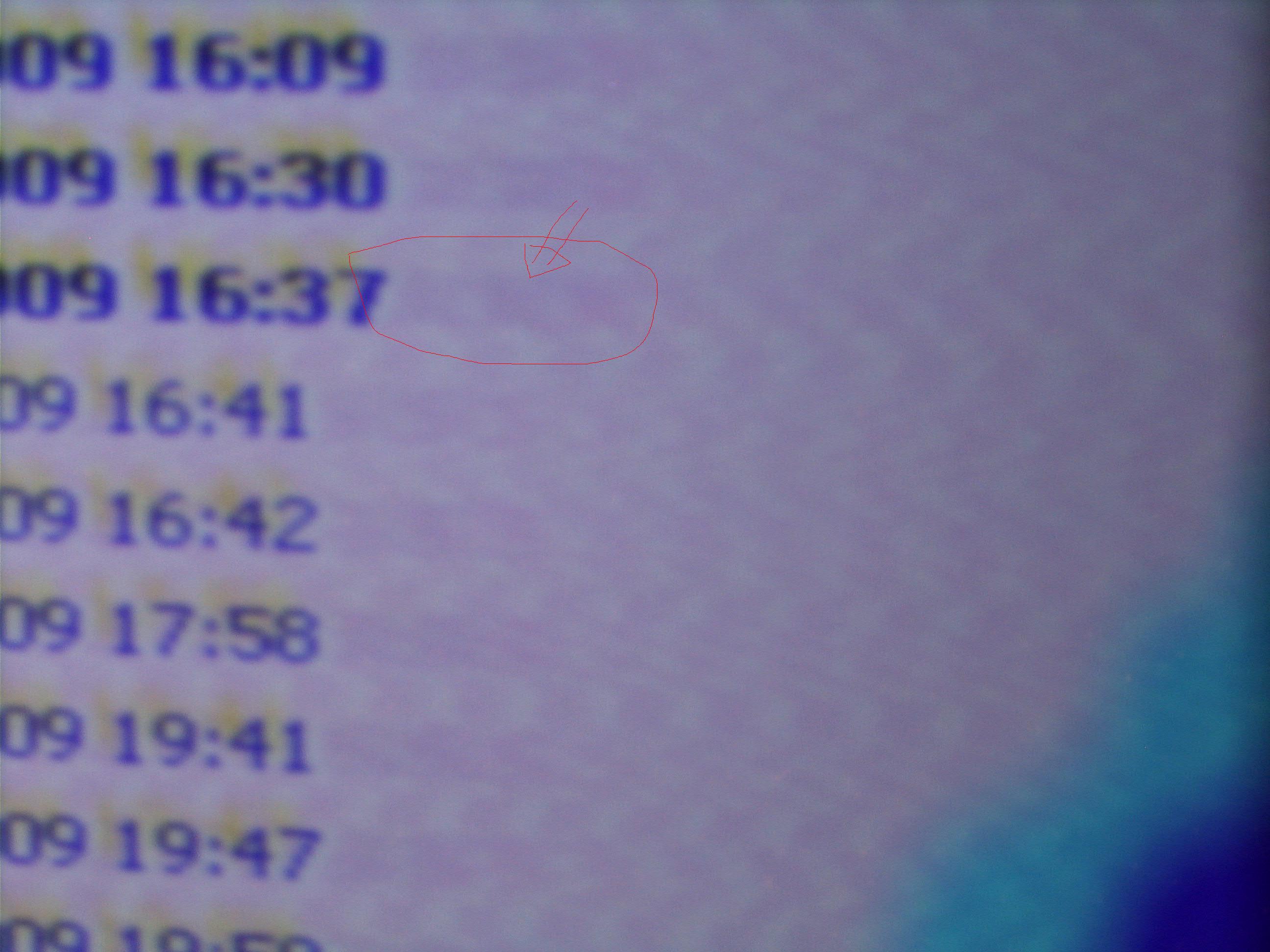

hi
i have an problem and dont no how i can fix this prob
the green tube flickers somtimes and mute a little bit sometimes, when green is muting then the green picture is not sharp
1:
i have sometimes these flickering lines on screen

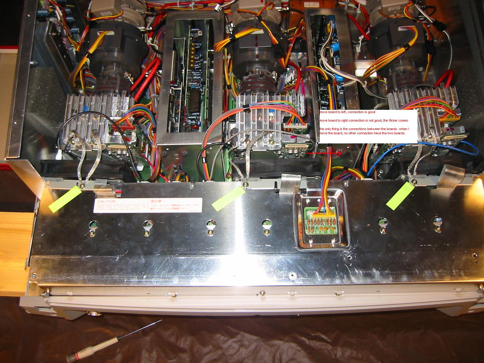

2: when i move this board from neckboard
see pic problem pic

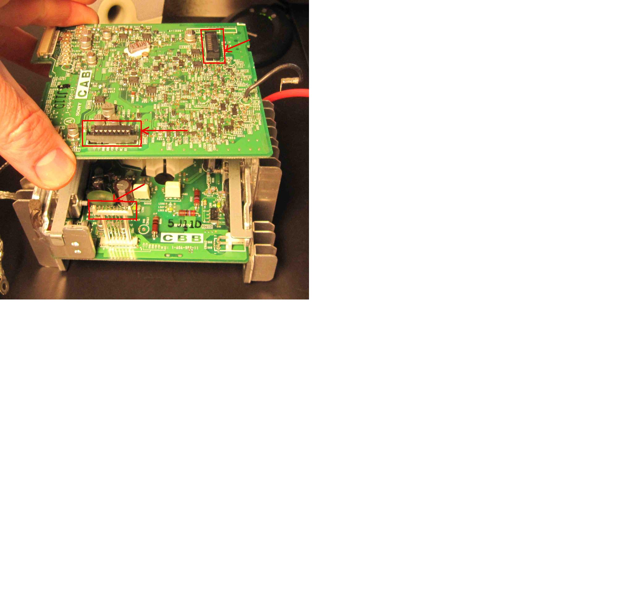

i think here are bad conenctions

i have changed the flatcables from green to red, and red to green and turn them on 180°
i opened the cardcage and look at all connectors, i see that the the 13 x plug was placed diagonally on the baord in the cardcage, i hope thats was the problem for muting the green tube
the flickering is always here when i move the pc board from the neckboard, hold the pc board in a certain position, the flickering is gone, move the pc board from the neckbaord into another position the flickering comes

the red neckboard is installed to the green tube, hold the board and totter an on cables, no problem
problem is only when i move the board where goes the flat cable and the black coax cable a little bit right and left
so i think here is an bad connection between the two pc boards from the neckboard
put the red neckbaord on the red tube is the same failure, as when i put the red neck on the green tube
is the green neck on green tube here is only the green tube muting sometimes a little bit and the image is not sharp but no flickering

muting problem from the green tube is gone after make the 13 x plug in the cardcage for the green neck into good position
the flickerproblem is here always when i move the pcboard from the neckboard where goes the black coaxcable and the flatcable
hold the pcboard in position and totter on all cables/wires no problem

I suppose Rogue has to seperate the 2 pcb boards from each other to be able to mount the mod module.
The 2 boards are connected with 2 sturdy long pin connectors, both have never been loose before until the mod was done.
When placed back I can imagine that these 2 connectors can be a little bit dirty/corroded or the contact joints suffer of all (dis)assembling work being done.
Because you say that when you keep the pcb board in a certain position it is possible that both long connectors are fine but not when you don't turn one pcb board a bit.
Also the fact that moving the coax and flatcable doesn't cause problems when this pcb board is held in one position makes me think that the problem is in (one of) the 2 connectors.
