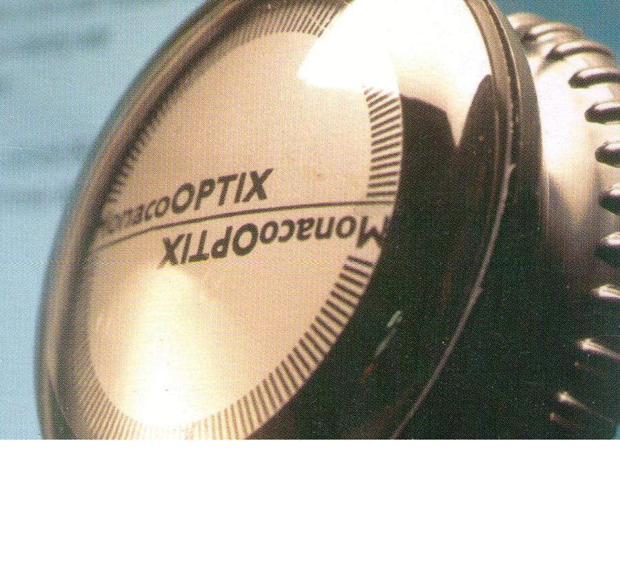

I have attached a picture of the Monaco Optix.... maybe a different model than the one you have been successful with. I would be pleased if you could confirm this.
Any other ideas would be greatly appreciated.

Thats really weird, mine is exactly the same name but looks like this http://www.sofos.sk/Prilohy/254060004060_0.pdf
Clearly different hardware, no wonder it doesn't work. The HCFR guys hang out a lot in the Calibration Forum at AVSForums, might be worth a try there.
Barring that, you could try sell the Monoco and pick up an Eye-One D2 or move to Calman perhaps but either way it will cost you money

Thank you for the confirmation on a different model of Monaco Optix hardware.
l think I'm going to have to purchase an Eye-One D2 if I want to utilize ColorHCFR.
