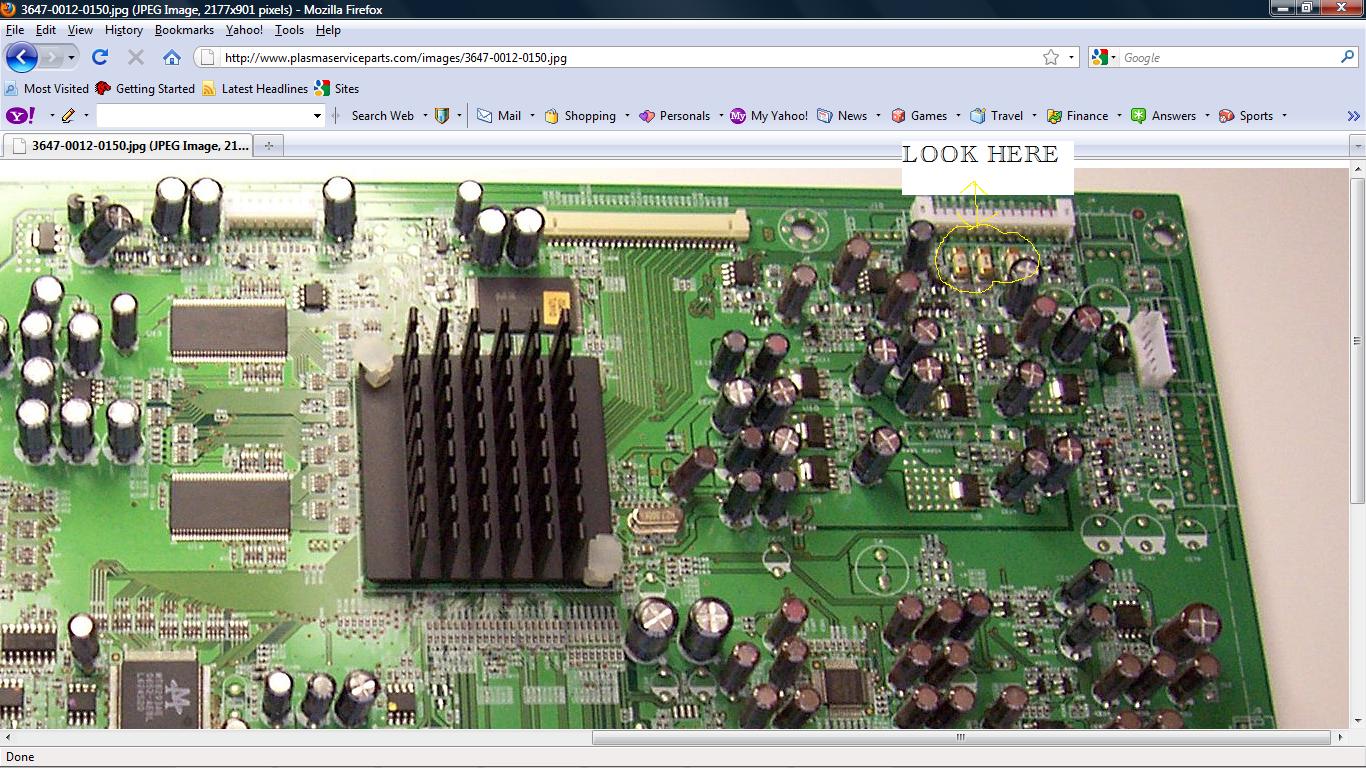

You probably need a new main board. You can pull it and check for bad solder joints and also check fuse F3 (1.5a). If still no go the check the inverters for leaking caps and also check fuse mf1 (10a) on the master inverter. If still nothing then replace the main. There are a few different mains for that set so make sure you get the right one for it.

I haven't taken the main board out and I do not see a fuse on it, unless it is on the underside which I doubt but nothing is impossible. This is the part number of the main board "Substitute Part: 3647-0012-0150". But if I have to I will remove it tomorrow to check closer. That part number is the one that is in there now.
Posted: Fri Oct 30, 2009 3:03 am    Post subject:
It should be on the upper right corner. Its a surface mount fuse so it wont look like a regular fuse. You have to test it with a DMM to see if its good or bad. Look for the location id that I gave you.
Posted: Fri Oct 30, 2009 3:18 am    Post subject:
Look here.

Ok Mac the first one is blown, the easiest fix seems like to get the the board. I will order a new one this weekend. Thanx for the help. When I get it and put it in I'll let you know how it goes.
Posted: Fri Oct 30, 2009 3:43 am    Post subject:
Why not just replace the fuse? That would be the easiest. That fuse is known to blow for no reason and replacement resolves the issue.

That would be a nice cheap fix. I might try that now that you say that. I was always taught that if the fuse blows, that something was wrong down the line. But maybe I'll check that out tomorrow, again thanx.
Posted: Fri Oct 30, 2009 4:18 am    Post subject:
You dont even have to remove the blown fuse. Just piggy back another one on top of it. Make it easy. And if it blows again then you can just order the board..... Smile
