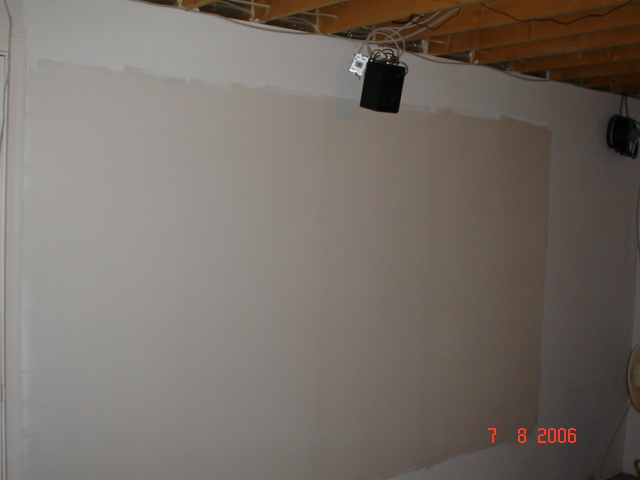

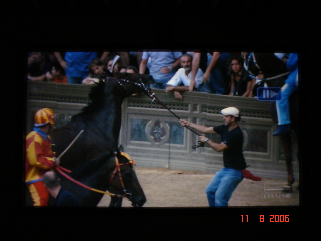

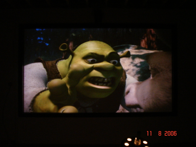

Actually, I am, Terry...I managed to take a few days off last month and got the screen goo on the wall.
I followed the manufacturer's instructions to the letter and it turned out great. I had to strain the base coat before I used it but other than that, it went on smoothly and leveled out nicely and I can't find any roller marks anywhere....it's not often that something works out so well for me!
Here's some pictures...
Chuck
At this angle, you can see where the wall studs are but from the front it is very smooth with no noticeable undulations.
