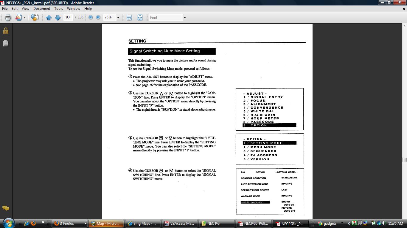

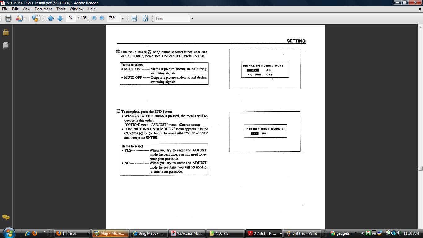

Posted: Sun Oct 04, 2009 3:45 pm    Post subject:
Here is the procedure for the pic mute feature. If you can smell anything at 5 feet from projector then something is getting hot. Run it until you get the smell, then turn it off and unplug it. Then feel around for anything real hot. No code output is still interesting other then there wouldn't be a code for no sync. The smell and lines is what is bothering me. If you turn off the pic mute and it stays on long enough to get a pic of whats going on, post it.

Hmmm, i never tried to bring up a menu after the picture muted.
The odour did not linger. I don't think it was a burning component, i think it was a burnt (past tense) component.
The magic smoke has leaked out already. Sad
Thanks for the picture mute tip. Is this something i would normally leave off while playing the PS3?
