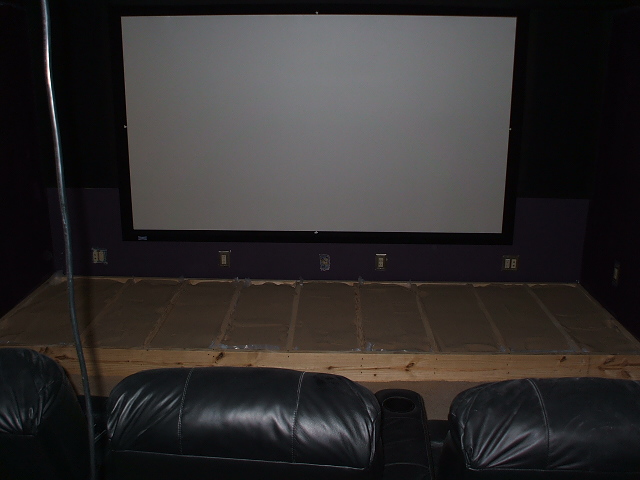

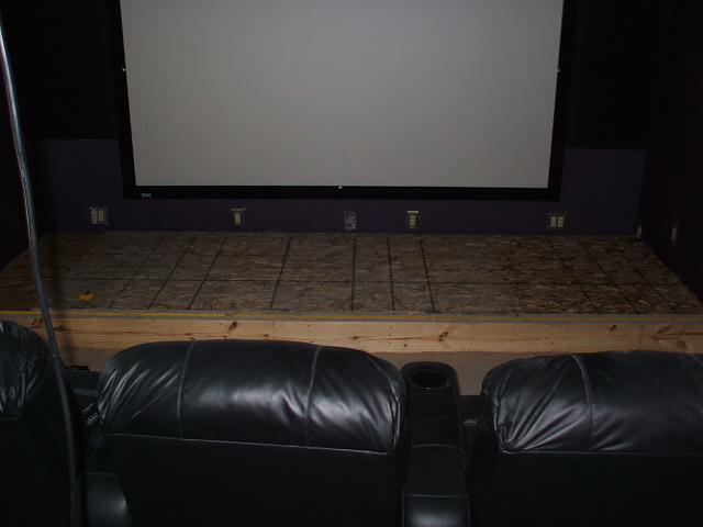

Not sure where one would post this as we don't have a construction forum on the site at this time. Thought I would post the pics of the stage I build that required all that sand.
Finished before carpet and screen wall. Each layer has seams in different places.
 Filesize:  109.9 KB
 Viewed:  11602 Time(s)

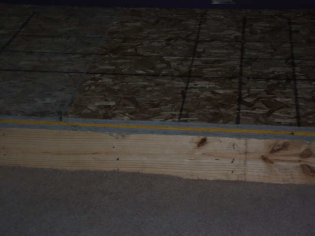

Decking Layer 1 3/4 OSB, Layer 2 1/2 OSB, Layer 3 3/4 OSB Every layer glued with liquid nails sub floor adhesive, and screws. over all about 250-300 screws increasing in length each layer 1 1/2, 2 1/2, 3 1/3
 Filesize:  117.59 KB
 Viewed:  11603 Time(s)
2x6"s sitting on top flat 2x4"s front cap 2x8 back cap 2x6" 2 tons of sand there after topping off.
 Filesize:  111.43 KB

Thank you on the comments It was based professional designs. Having a stage simple helps frame the picture either side will have a false wall up to the screen edges. I'm building the false wall to move the screen forward right now, then on to the side towers for the speakers.
Next I will be building the riser. The riser will probably have 75 sq. ft of insulation. Will be build mostly the same save for the sand.

I am planning a stage for my HT also but I'm wondering about the sand. I can understand that it will pretty much eliminate resonance, but if the speakers, assuming you have floor-standing ones, were not on the stage, would the sand still be necessary?
My plan is for a 16 inch high stage directly under the screen, which will house a centre channel speaker as well as two subs, all completely isolated from the stage itself, and then there will be two shorter wings (10 - 12 inches) on either side of the stage, upon which my tower speakers will be.
I'd thought about filling the wings with sand, but should I consider the centre section also and if so, why? I fear I'll be looking at a touch more than two tons, which is a lot of sand to schlep into the basement.

Posted: Tue Aug 29, 2006 4:45 am    Post subject:
if the speakers are not on it then you would still need to pack it with R13 or R30 insulation to prevent resonating. I did my riser the same as my stage except it's packed with 4 rolls of R30 insulation. I turned it into a large bass trap using two register covers Wink Hemlotz Resonantor baby...
