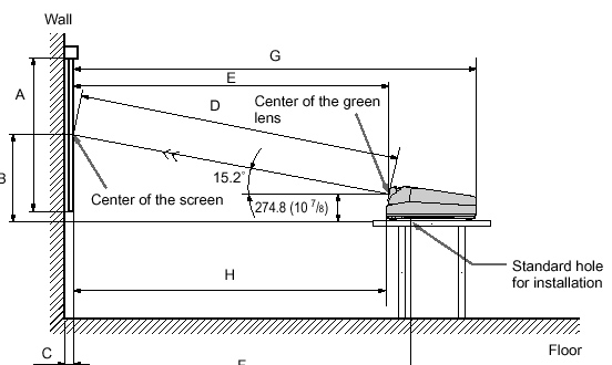

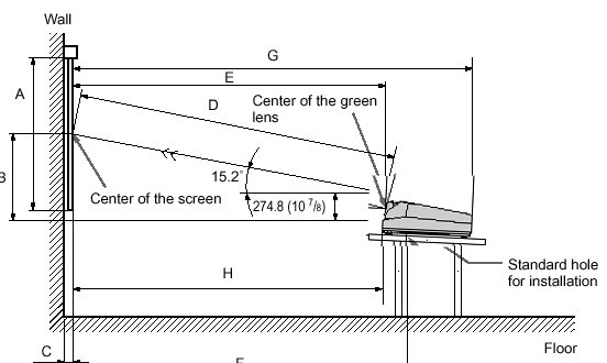

Hi!
I'm a new-bee in the business Cool
Can i tilt the projector and have it 4 inches under the end of the screen.
Or should I avoid keystone just like on a digital?
Thank's

you can tilt its just that if you want even burn in of the tubes cause you might change your set up in the future then you might not have a clean tube face to work with. otherwise its fine as long as its not too much of an angle. its been discussed here before what the most of an angle you should go but as long as the keystone can cover it then thats your limit, albeit might not be the best solution.

What projector? G70? 4" off the edge of the screen sounds like less than "typical" offset. What's your screen size and throw?

Posted: Sat Sep 05, 2009 3:00 pm    Post subject:
The size of the screen... hm, i think around 94"
The distance is 2.6 m. Yes a G70 Smile
Posted: Sat Sep 05, 2009 4:10 pm    Post subject:
OK, so a 94" wide screen and a 2.6m throw - that's almost identical to my setup. For reference, my offset (screen edge to green lens center) is probably pretty close to yours - maybe even a tad more. That's not far from typical.
FYI, the only way to eliminate keystone altogether is to mount (or hang) the projector such that the lenses are centered on the screen with the rear of the projector tilted. Rear-projection setups are the only installation that typically accommodates that setup well.
In short, you're fine.

Posted: Sun Sep 06, 2009 4:27 pm    Post subject:
in peace:
From what I understand, yes, you can tilt the projector. Yes it will make adjusting it more difficult, and yes, it causes uneven wear (or more accurately non-rectangular wear) on the tube surfaces.
And from what else I have gleaned, it is also more difficult on the projector itself as the guns are bending the image to fit the image rectangularly on the screen. This also seems to cause other issues with the image as pixels are getting "squished" or expanded to make this happen. I could be wrong on this, it's been a while since I have read up on it, but that is my rememberance of what I read.

The issue is how high I should put the projector?
The white on the screen starts at ~ 41cm / 16" from the floor. I will go for no tilt.. Thumbs Up

That's all true, but it's also the nature of the beast. As I explained earlier, unless you're mounting the projector centered on the screen (both horizontally AND vertically), there will be vertical keystone dialed in. Problem is, almost no front projection installation can be done that way because it puts the projector smack dab in the middle of the room - horizontally AND vertically. A very few people can get by with it if they put the projector on a stand about 4-feet tall, directly behind and just over the head of the viewer in the sweet spot. I'll also point out thought even in the zero-offset configuration, you'll have horizontal keystone dialed into both the red and blue CRTs.
The other 95% of us floor- or ceiling-mount our projectors and have an offset with keystone compensation.
Check your manuals for your particular projector's nominal throw offset.
Posted: Mon Sep 07, 2009 3:54 pm    Post subject:
A couple more things...
1) My G70 is about 120" from my 96" wide screen, so the throw is about 1.25x screen width. That's slightly inside the PJcalc-recommended distance, because I wanted to be a little more conservative with the raster-maximizing, because I wanted excellent corner focus.
2) My machine is dropped from the ceiling at the front, and raised at the rear to aim tube-center at screen center.
3) I don't remember what my offset is, but I think my green lens-center is probably 6 inches or so outside the screen border. Don't recall what throw angle that represents.
Hope that helps.
