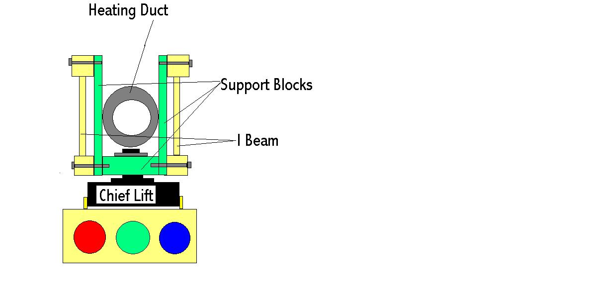

Ok, I'm almost ready to install my Chief electric lift, and have a couple of questions. My theater room in the basement has wood I beams in the ceiling, and the spot where I need to install has a heating duct running through it. My questions relate to support blocks between the I beams, and the actual installation of the lift through the bottom support block.
I drew a crude diagram of how I think it should go, but would love some input.

Do I drill a hole in the bottom support block and feed the threaded mounting tube through the hole, and then put the nut on. Here is a pic of the lift with the round tube on top for mounting.

Seems to be a well thought and sturdy way to do it to me. And yes drill your hole in the wood just as you have shown in your pic.
Is the bottom part where your lift is bolting through a couple of 2x4's on end? More than strong enough for 250 Lbs. Thumbs Up
If so make sure to glue them to each other and use screws also staying clear of the part you are going to drill into.
Just to save your drill bit or hole saw a lot of wear.
One more thing if that "nub" that has to go through is larger than 1" use at least 3 2x4's. sandwiched together.

I was going to use 2x8's to build the U. I never thought about using glue as well as screws. Will do, thanks.

Looks pretty good to me. (I'm an over-engineering type) Can you use the four bolts that hold that plate with the nub on? Remove the plate and just run bolts thru the bottom of the U into the mount? Might gain some headroom that way.

The four bolts that hold the plate actually come out of the lift, so that doesn't seem to be an option. The university that owned the lift fabricated a steel plate to go under the large nut, and on top of the support block.

Mike, what kind of beams do you have in your ceiling? Mine are engineered I beams, they have a 2x2 on the bottom and the top and particle board in the middle.

Mine are just plain old 2X10's. Engineered beams could be a challenge. I didn't feel comfortable just lagging in from the bottom. I drilled holes threw the joist then bolted uni-strut "L" brackets to the joist, then bolted the uni-strut to the "L" brackets. I think your beams run the other direction, so this would not really be an option.

I'm not the one to tell what you are doing is right or wrong, but please look at page 6 in the upper left hand corner of this document: http://www.ilevel.com/literature/TJ-9001.pdf
Suspended loads need to be through the web of TJI's.

The part about using engineered lumber as backing, because regular cut wood can shrink. Can I just go to home depot and ask for engineered lumber? Can it be cut? Sorry, I don't know a lot about wood.
