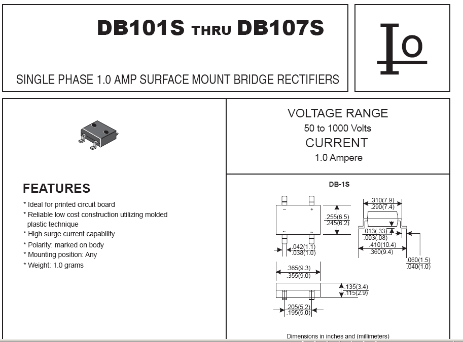

I don't know how you guys do it. I have a SMT IC to identify. It has four legs and is about 1/4 X 3/16 inch in size. The markings on the top are as follows.
-5179+
PEC (and then some type of symbol) Then the bottom line is kind of funky
Bt102S I'm absolutely sure about the 102S. The "Bt" is questionable.
This is from a heating control that I'm trying to fix. Thanks,
RogueChili

Posted: Sat Aug 22, 2009 9:10 pm    Post subject:
One possibility
 Filesize:  37.72 KB
 Viewed:  3084 Time(s)

I'll try and take a picture of it later if needed. It is a bridge rectifier. I'm puzzled by the spec. This digital control is dual voltage. You can feed it 120VAC direct or 24VAC through the same connections. The DB102S has a maximum sustained voltage of 100V. Why did they not use a DB103S which has a max limit of 200V?
We have been replacing these controls to the tune of about 1-3 a week. They all seem to fail the same way. They are all wired 120VAC. They seem to fail after a power outtage or when you shut off the service switch and turn it back on. It then makes a loud buzzing noise and dies. This one that I have in front of me is buzzing, but has not died yet so it's a good candidate to find the problem. Rat shack has a 200V bridge rectifier that is through hole but I can make it work for a experiment.
I could just continue to replace these but the Co. that manufactures them is chapter 11, so who knows how long they will be around to provide replacements and we have a pant-load of these that we sold in the field.

Looking at the datasheet myself I would even go for the DB104S, that will give you some decent margin for voltage spikes since the maximum RMS voltage of the 103S is only 140V. As an replacement there is the DF04S from Diodes inc or Vishay which you can purchase through Digikey at a cost of $0.78 for the Vishay version.
The original part was obviously severely under-designed for 120V, I wonder how the rest of the circuit handles 120V.
