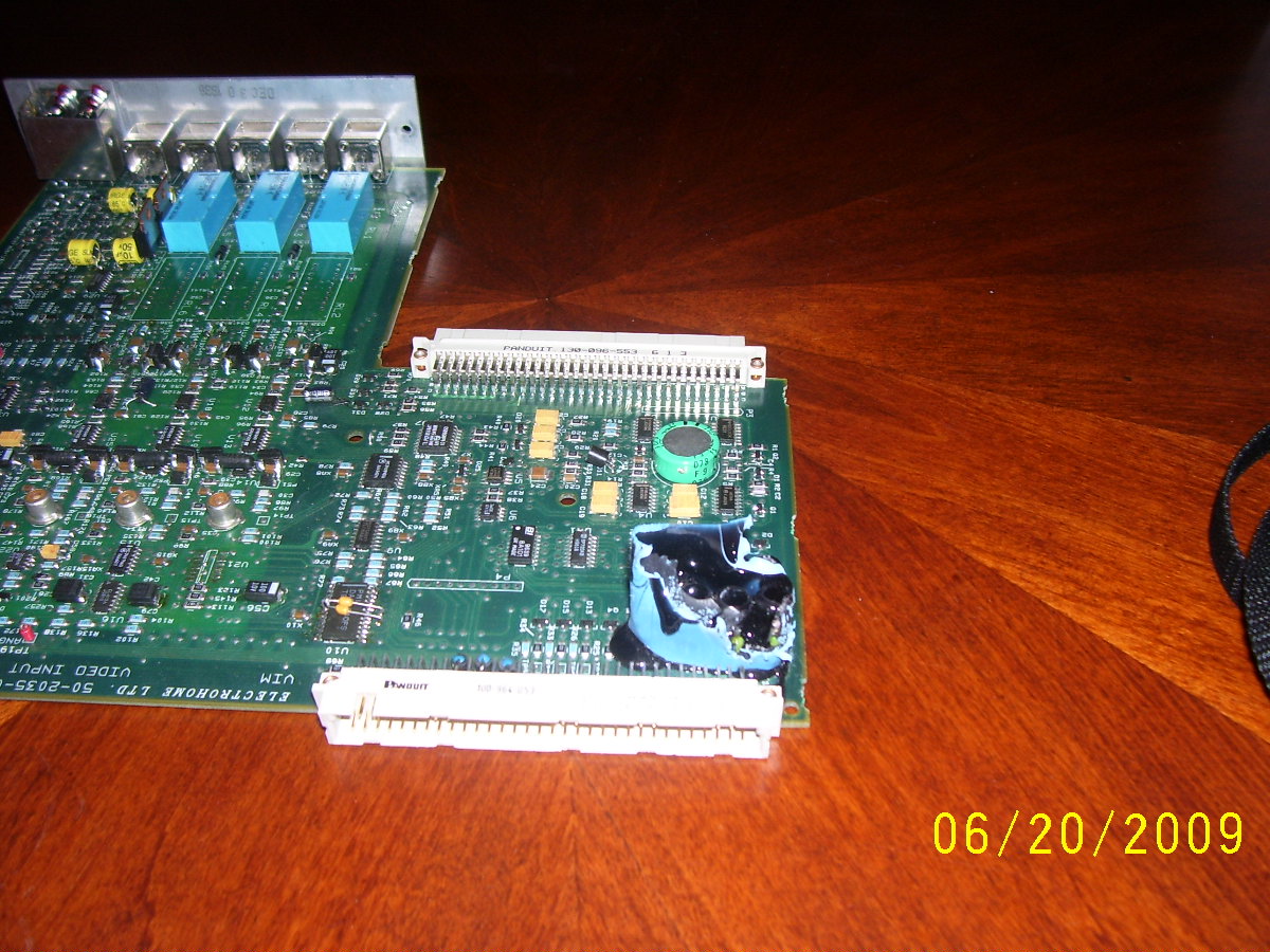

I'm going to take a wild guess here and say the VIM is the problem. I went to swap the cables and when pulling the board forward to get access I noticed 4 black [caps?] wrapped by some blue shrink wrap near where the Moome card plugs in at has melted the shrink wrap.
