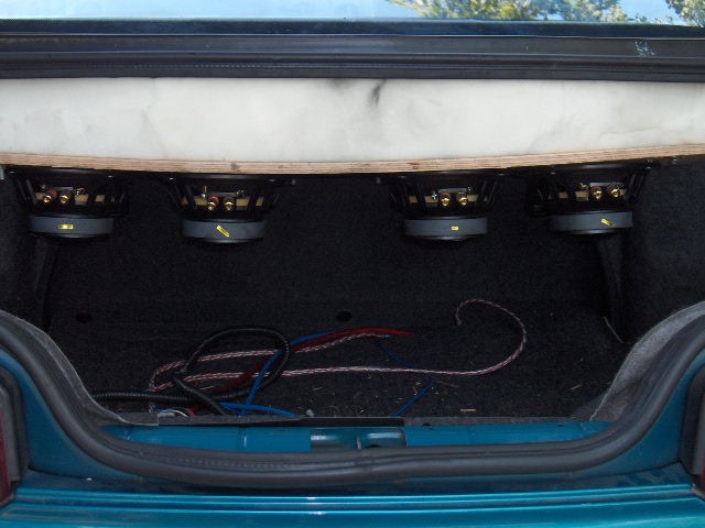

Loosely mounted woofers and foam to back deck. Amp wiring and installation to follow.
 Filesize:  93.16 KB
 Viewed:  10457 Time(s)

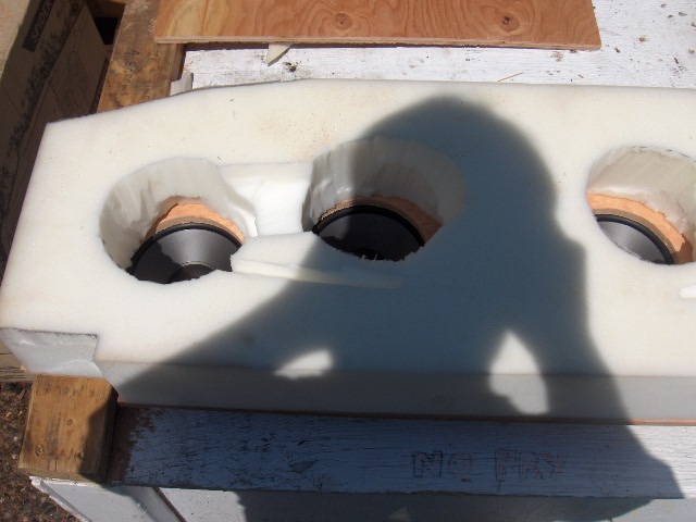

Foam with woofer cutouts. I should probably have used a hole saw, but I'm not paying big bucks for something I'll use once!
 Filesize:  81.06 KB

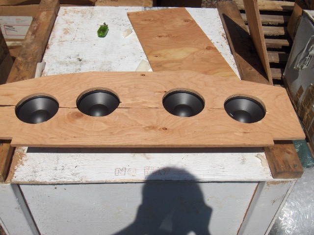

4X 6 1/2" woofers from Parts Express on board to be mounted under back deck
 Filesize:  108.07 KB

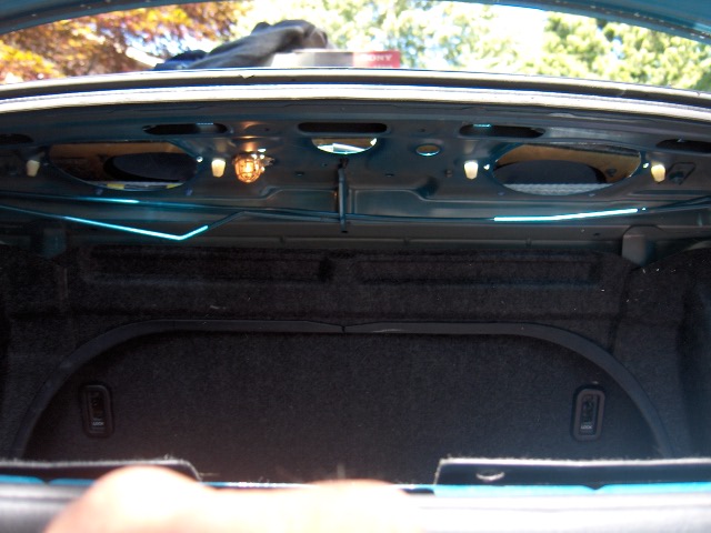

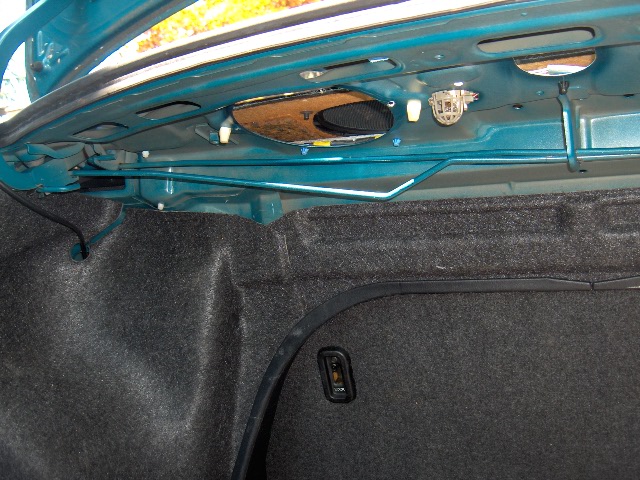

Closeup of 6" speaker hole, with cardbord back deck cover
 Filesize:  143.72 KB
Underside of back deck showing those nasty trunk springs
 Filesize:  92.89 KB

The saw, the hole saw, and nothing but the saw.
Posted: Tue Aug 04, 2009 3:14 pm    Post subject:
Yeah, it's not quite up to your precision level, is it? Smile I figured a standard hole saw would shred the foam, and since it's for sound absorption anyways, I figured other than looks, a rough edge wouldn't make a difference.
Posted: Tue Aug 04, 2009 3:39 pm    Post subject:
All the upholstery guys use an electric carving knife.
Posted: Tue Aug 04, 2009 3:42 pm    Post subject:
Yeah, I didn't have one of those either. Sad
