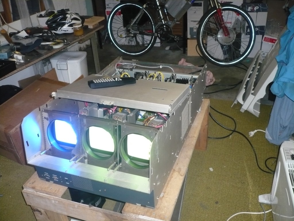

Posted: Mon Jul 20, 2009 3:54 am    Post subject:
I can take pics, and I'll have a look carefully how the covers attach - see if a mount could interfere.
Lucky for you I have an 808 sitting on a table in my shed - it arrived Saturday.
Mark_A_W
Joined: 15 Mar 2006
Posts: 3068
Posted: Mon Jul 20, 2009 4:00 am    Post subject:
A pic here, not too helpful, but it's the best I have onhand (I'm at work).
You can see the covers on the ground.

Posted: Mon Jul 20, 2009 4:11 am    Post subject:
I can't add the nifty little arrows. But the slots on the side are where the panels mount. If you look at the panels you can see the tabs I mentioned earlier.

Posted: Mon Jul 20, 2009 1:13 pm    Post subject:
Oooohh, the whole thing is one piece - I assumed the different colored sections were different pieces, but apparently not. Yeah, can't really see exactly how it works from that pic, but it's something.
