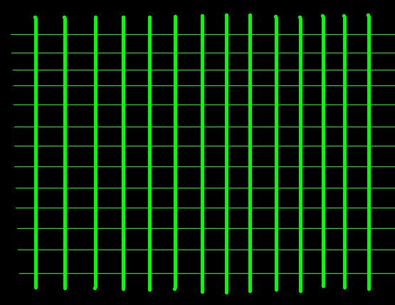

So after re initializing my Dallas chip the PJ now turns on and there are no error codes showing YAY!!! Very Happy . I did however turn on the PJ and for my own curiosity very quickly and very roughly adjusted the red green and blue tube focus with the 2 nuts on top of each lens and now to my issue..........

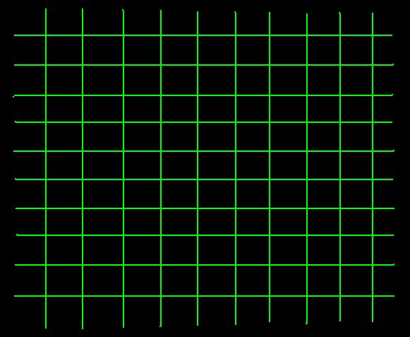

When focusing the green tube on the cross hair pattern I notice that all the horizontal lines focus great and look very crisp unfortunately the vertical do not seem to change focus at all. without taking a snap shot of the problem ( i will if need be) it is best explained with my drawing below
What I should get is the GOOD file but what I get is the BAD file. Can anyone explain this and what setting fixes this?

To me that looks like you need to work on the astig.
Posted: Sat Jul 11, 2009 6:31 pm    Post subject:
Correct. Also, lesson learned, esp with the G90, I would NOT do Dallas chip and EPROM messing around unless the set fails. most Dallas chips last 15-20 years, and with the Ya board being somewhat problematic in the first place, and no spare parts being out there, you're playing with fire every time you dive into it.

Thanks. So the settings for the astig were stored in the dallas chip that I have since lost by replacing it. Thats not so bad then. I thought that it was something wrong with the tube.
