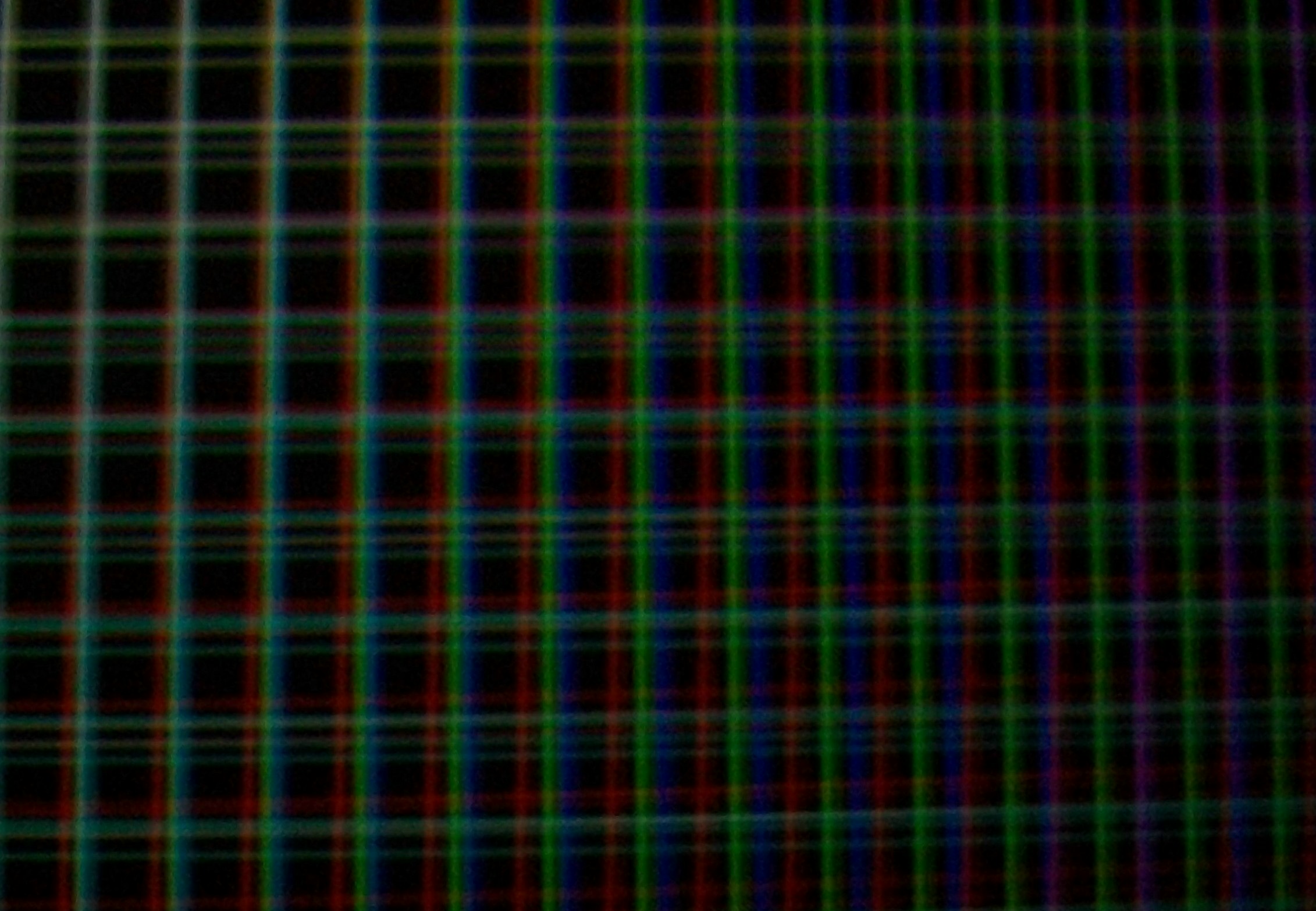

However ive come across another problem,doing geometry with an external pattern or internal pattern or genlocked pattern: after all adjustments are done with the green using a x hatch pattern its perfectly centered and nice and square and straight on the screen the red and the blue should be converged very closely to the green but they are a really long way off.It appears that they are not moving with the green adjustments at all,the red especially needs what looks to me like some serious keystone adjustments and the blue not as far off but bad all the same.
Have i missed a critical step somewhere?
Or does the PJ have a physical problem?
Have added some screenshots,my photography skills are severely lacking but i hope this gets the problem across.

gan:
Have you zero'd out all the convergence settings on your PJ? If your's has a Service menu, you can do it from there. I am guessing (meaning to ask Curt or someone else here) that deleting all blocks may do that as well (Curt/anyone, is that the easy way of getting around my lack of a Service menu to reset all the convergence settings? Simply delete all the blocks? Also, I am presuming from what I have read that the PJ automatically recreates the blocks it needs for it's internally generated patterns and logo screen and menus?)
I've noticed that my PJ, because each input/block has already had it's own settings/convergence done, displays each input source differently. For instance, when I displayed RGBHV via a PC at 1024x768x60Hz, everything was shifted far left and the left side had major keystone and bow issues - as well as major raster "drift" of the other colors (much like your right side). That was after aligning everything via the "Installation" phase. I fixed that (well, mostly) but when I switched to S-Video, everything was shifted left and there were entirely different convergence issues. Switching back to RGBHV and that was still "fine" (ie: as good as I got it till I decided I was done with it for now).
So, it seems that each block (ie: each input used plus it's resolution/refresh) stores it's own convergence, raster positions and such.
The other thing I noticed is that if I do large raster shifts (or sizing) of the green, then though the blue and red follow, the convergence gets messed up - I would definitely do raster shifting, sizing and alignment before convergence. Following the Installation prompts I think does it in the "correct" order. Also, raster shifting or size corrections seem to affect each other.

Convergence is the last step.
If you adjust the trim pots for size / raster position for the R and B, you can get things sized and centered basically correctly before you do convergence. You can adjust R and B position vs. G with fine convergence, but it's best to keep those adjustments to a minimum if possible. At least, that's the dogma, and I don't question it despite my not being aware of the technical details!
You can adjust raster size during 'guided setup', although the menus are a pain in the ass.
And Robert is right; adjusting any geometry will hose your convergence to some extent and you'll need to tweak it. That's normal.
