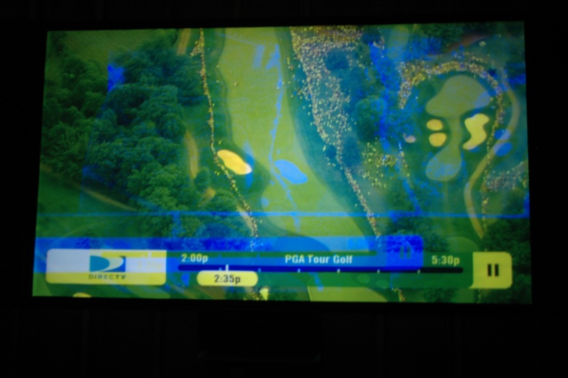

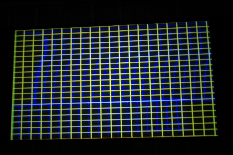

Got an Ampro 3300. That's my first problem.... Lately, when powering the set up if I have registration turned on, the blue image is all screwed up (see attached pics). If I turn off registration for a bit and let her 'warm up' and then turn registration back on, things go back to normal. For the most part. I usually get pretty bad drift of the blue image after an addition 10-15 minutes. If I go into the Help/Setup menu and exit the screen without doing anything else, the blue image aligns itself and I'm good for another 10 minutes. Or 3. Or 4 hours. It's completely random.
Any ideas? I've checked the battery voltage on the CPU board and it's fine. I've done a few complete setups from scratch, but the end result is as I describe above.

This is caused either by the reggie board or the output board right by the reggie board. I can repair both.
Posted: Wed Jul 08, 2009 8:05 pm    Post subject:
There is a short 8 wire cable that goes between the reggie and the drive board. Fire it up and wiggle that wire at both ends. I've had that wire fail where it's crimped within the connector and drove me crazy with exactly the same problem as you have.

I'll be damned if it wasn't that friggin wire that stefuel mentioned....I had that tray unfastened so it was hanging down, must have been putting some tension on that connector. We'll see how long she's good for tonight.
