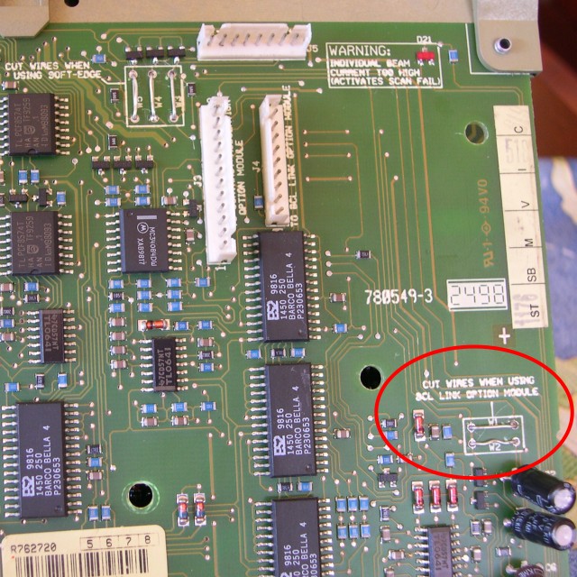

OK - maybe Curt is onto something talking about a jumper on the connectors themselves??

@Roland
In my R762720 there are BCL link Jumpers (when soft edge and BCL Link boards are installed).
 Filesize:  136.24 KB
 Viewed:  9414 Time(s)

Circuit diagram for the 1209s with the jumpers to cut shows pins 1&2 3&4 etc connected. To use soft edge the links are cut so the pins are no longer linked.
The Circuit diagram r7627205 for the 909 cine 9 board shows them linked but when i buzz them out they are not.
I'm thinking now that pin 1 goes to SEMU and pin2 is the video return etc . If I made up a plug connecting them ?

Posted: Wed Jul 08, 2009 8:57 am    Post subject:
Domenico
Thanks for that, it getting clear that the 76270 and 05 boards are very different.
Interestingly your board has the beam current LED so is a late version of that card.
The links you point out in your picture are what I have via the connector with two wires on my top picture.
What I'd like to hear now is comebody with a Cine 9, Cine max BR909, BR919, BR908 runco 1200 with the R7627205 RGB board.but WITHOUT SEMU fitted. Is there a connector strap / Jumper in J5
