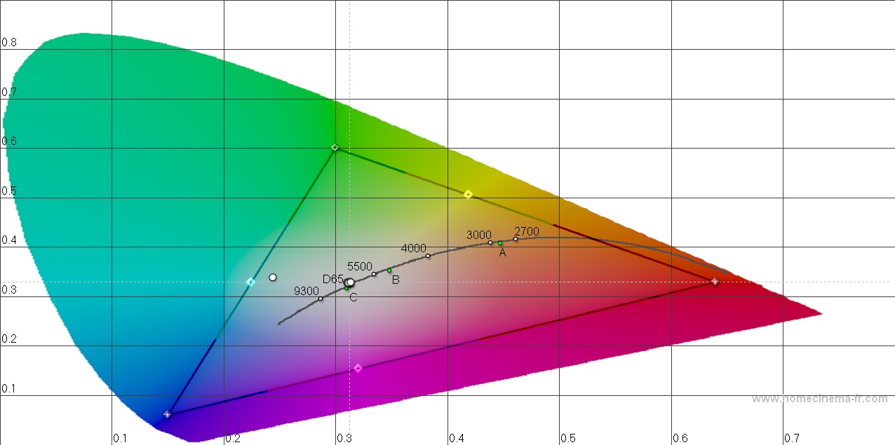

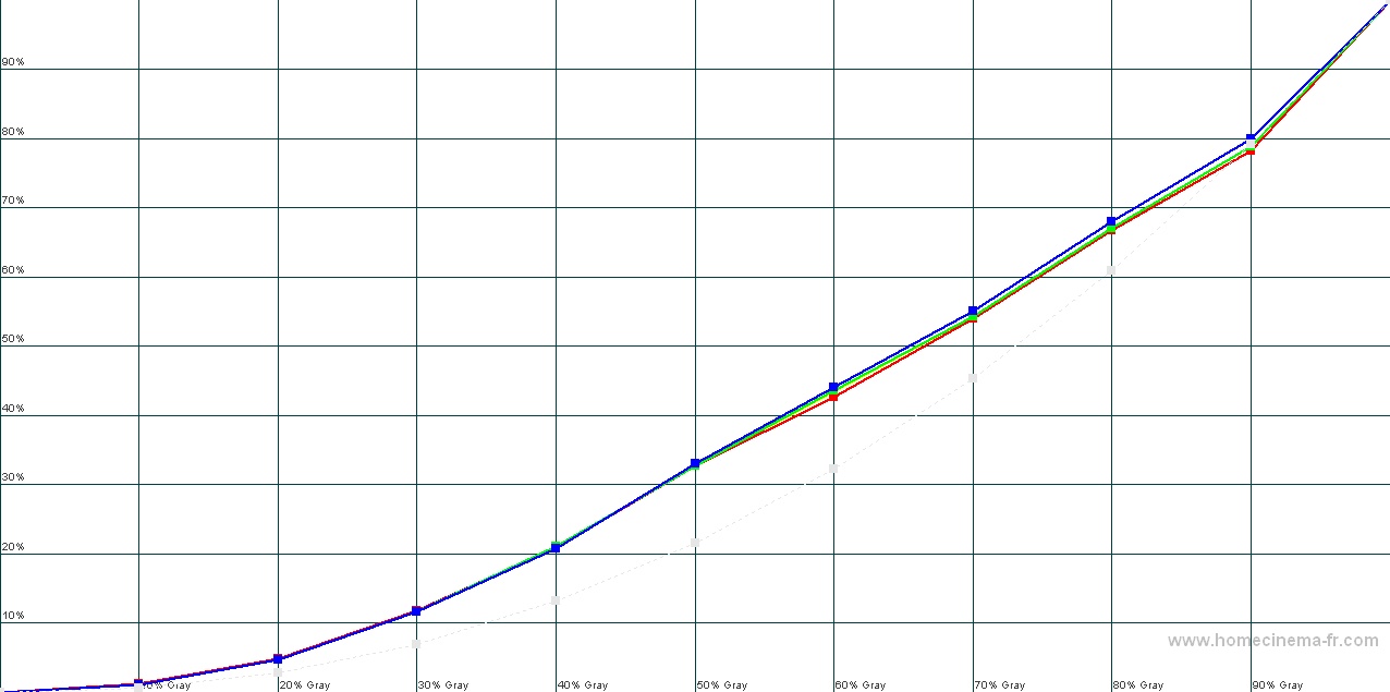

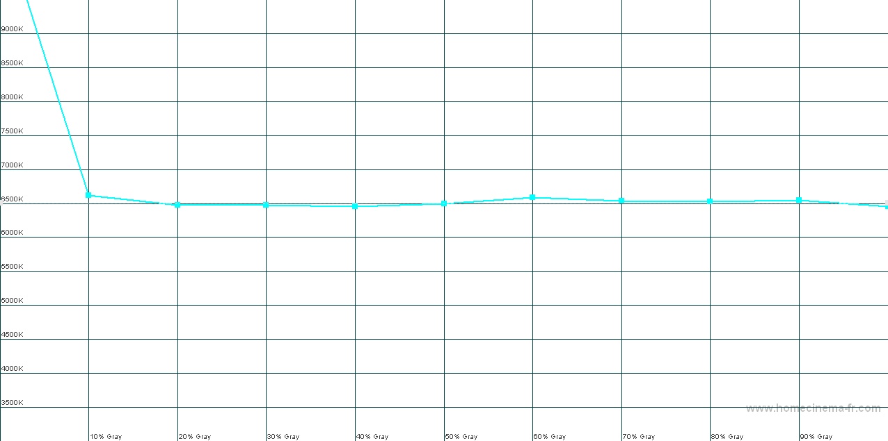

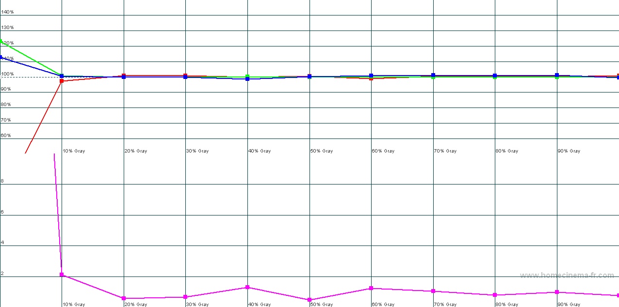

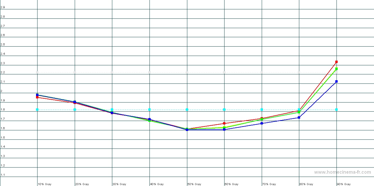

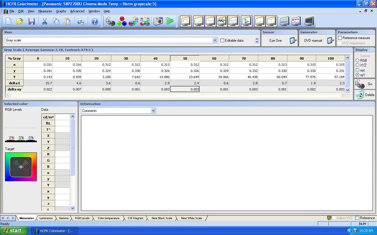

Here's the Calibration in Standard Mode with it set to Warm.
I have contrast set to 23, brightness to 5. Just can't seem to get the Luminance and Gamma the way I want it.
What do you think?
